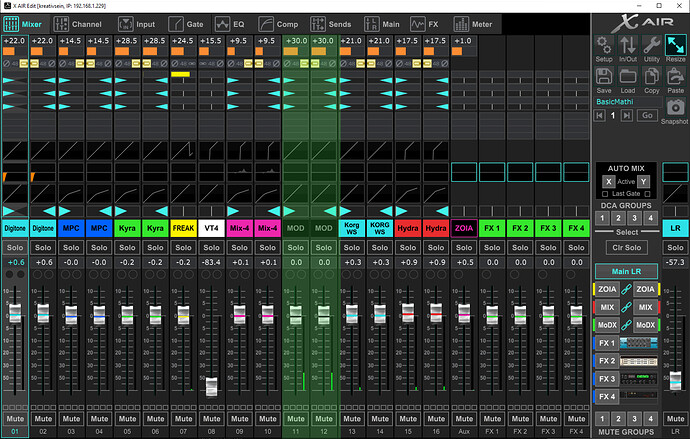

ok no freezes with rc1. but now i got the old behaviour. like full red output leds at 50-55% level and clipping. with rc2 no red leds at 75% and no clipping. also the effects sound much much better.. not so smuddy.. this cant happen right? but i swear i dont change any just the fw.
i also added a screen there u can see the noise. i also use the zoia there are no problems.
