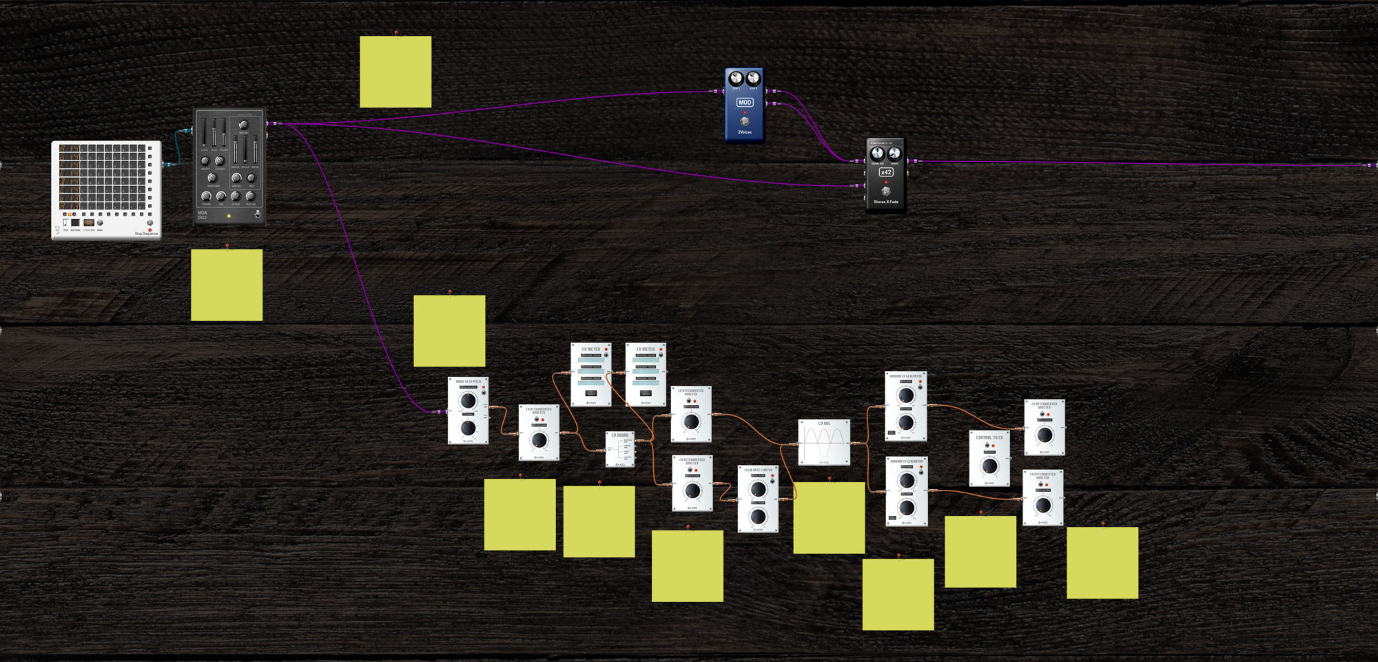

…just getting through a bunch of shows with a pedalboard that uses this idea. once things settle a bit, i’ll put together a clear board to demonstrate!
ok, here’s a simplified demo board showing how this works:
…there are Notes all over the board explaining everything.
have fun!
