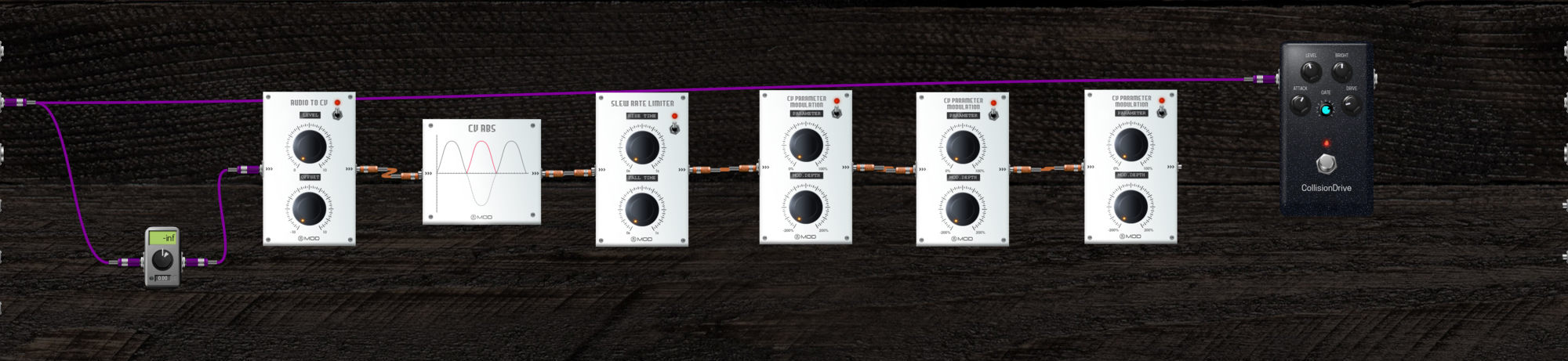

Last year I had this same question about using audio as expression, Julien has come with some ideas which worked very nice:
The audio2cv plugin indeed does not provide this functionality.
Its purpose is only for pitch tracking.
You might be talking about the AudioToCV Pitch plugin. This one, indeed, outputs a CV value related to the input pitch.
It’s a shame that the Audio to CV plugin has almost nothing in the description. Its outputs value is actually related to the input volume. I just made a test with the CV meter plugin.
So I think @Kopplog’s issue is not here. Maybe he needs an Attenuverter Booster to multiply the output CV value. Or it may be due to an incorrect use of the AMS VCF.
That’s indeed a good place to start. These pedalboards show that the use of CV plugins can be quite complex and they may help understand things where the documentation fails.
You can use the CV meter plugin.

Helped greatly, thanks @Lukasz !
Though, not being able to getting this done with less is quite a shit-show :poop:
