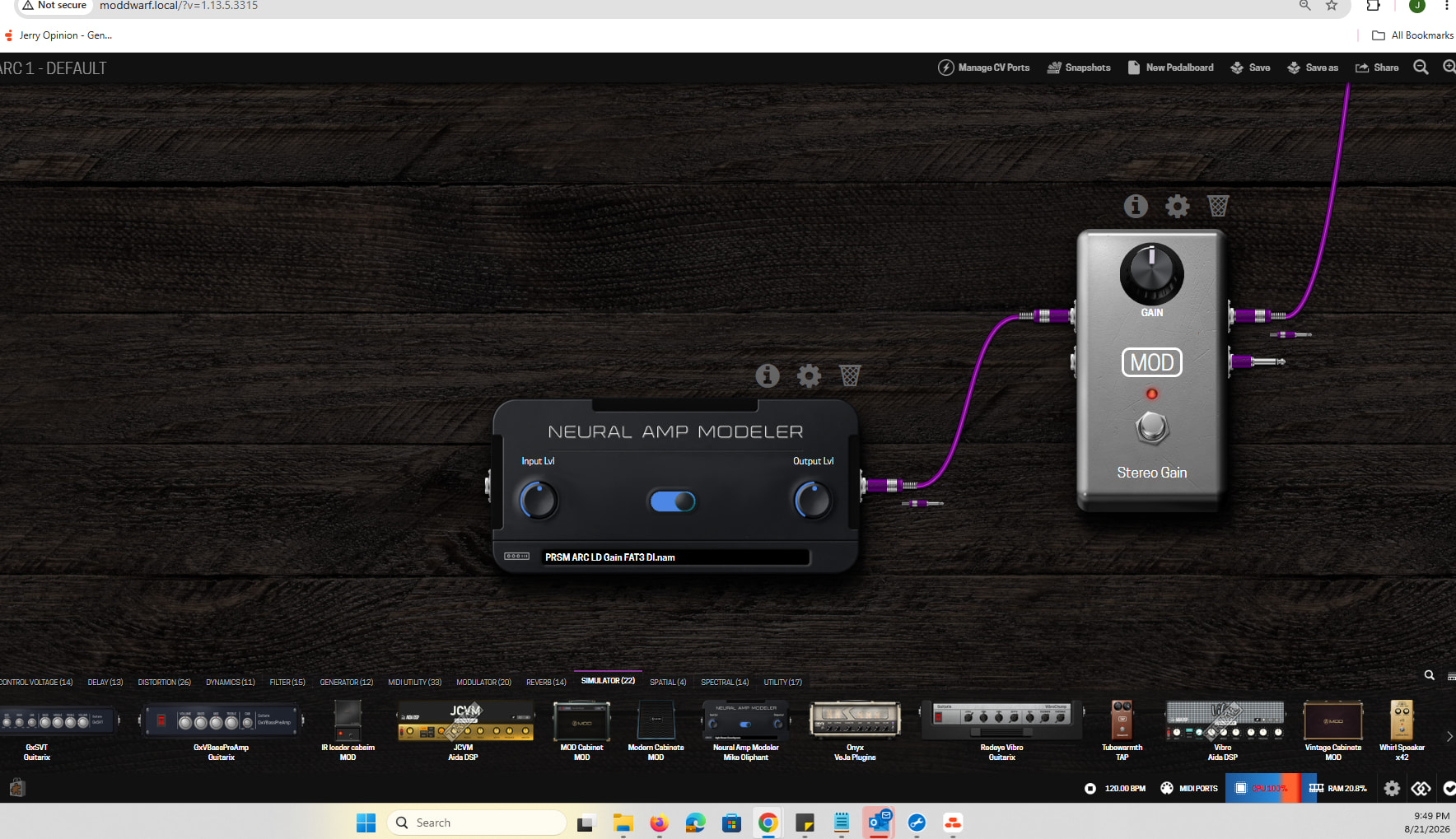

I recently purchased the Amalgam PRSM ARC NAM DI pack, which is based on the PRS Archon amp. I was really excited to use these captures, but when I load one of the PRSM ARC NAM files on my MOD Dwarf, the CPU usage gets extremely high and basically maxes out the Dwarf.
I made sure the NAM plugin is set to Lite, but I still have the same CPU issue.

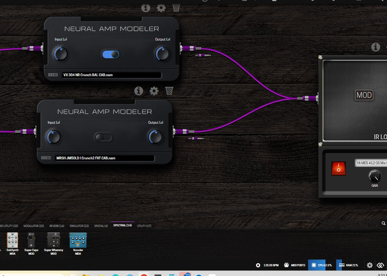

What confused me is that I previously downloaded some of Amalgam’s free NAM captures from TONE3000 (I believe the Vox and Marshall captures), and those work very well on my Dwarf. I can actually run two of those NAM captures at the same time without the same CPU problem.

I’ve attached a screenshot showing the CPU usage on my MOD Dwarf.

I think you need a A2 lite version to get it running smoothly. I run 2 lite models in parallel with added effects like in your second screenshot.
