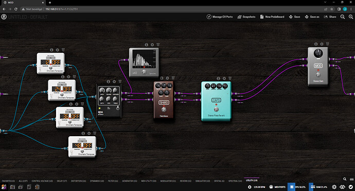

@Jarrydactyl , I did a quick check for you, and this is the CPU load (36.5%) with 60 voices of a Rhodes sound + harmonic trem + reverb.
Tested by holding down a full octave of keys, and layering it with +oct, +2oct, +3oct and +4oct.
Thanks so much for testing this Jesse: really appreciate it. Yep that ticks my box. Now just to order one…
