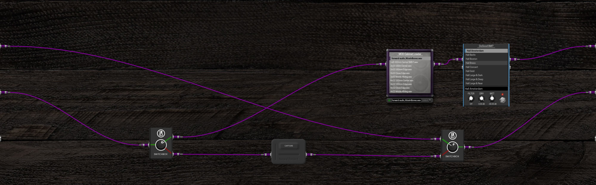

Just set up a little pedalboard for capturing, really love this plugin!
It’s set up so channel 1 is a normal signal chain, instrument in and out to DI or amp etc. Channel 2 is the FX loop where you can place the pedal you want to record. I’ve added 2 snapshots, one that lets you play and dial in a sound and test it, once happy switch snapshot (footswitch B) to Record and start the capture (footswitch C). I’ve added some optional reverb and cab sim on the Test channel too.
