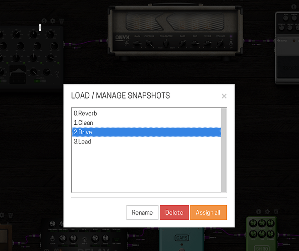

This board, created by Mod Dwarf, is said to have four types of snapshots: reverb, clean, drive, and lead. But when I load it on my dwarf, there are no snapshots available.

If they are using v1.11, the snapshots in there are not compatible with older versions, so that could be why.
Just tried it here and it works as expected.
My Dwarf is 1.10.4.2377, so that makes sence. Tried to update and click on Mod releases, but that page throws 502 Bad Gateway https://wiki.moddevices.com/wiki/Releases

Yes, this board was created with v1.11-RC2.
Updated my Dwarf now. Pedalboard working fine. Thanks!
