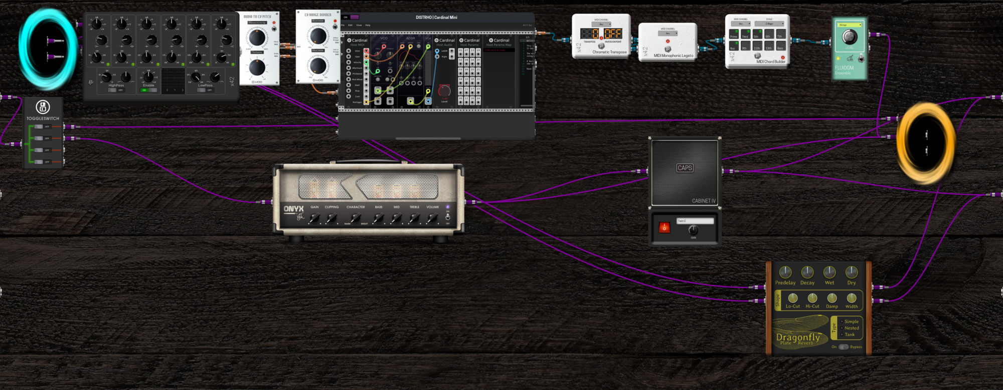

Speaking of Galactic Reverb I think that zwabo find a superb way to use it:
here another possible way to ambient pad
