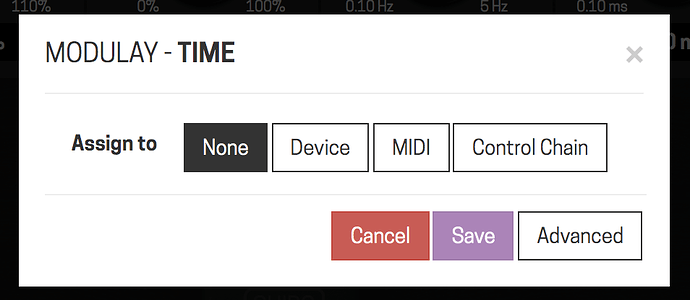

I don’t have that pulldown and tempo checkbox.
Everything updated, no pulldown.

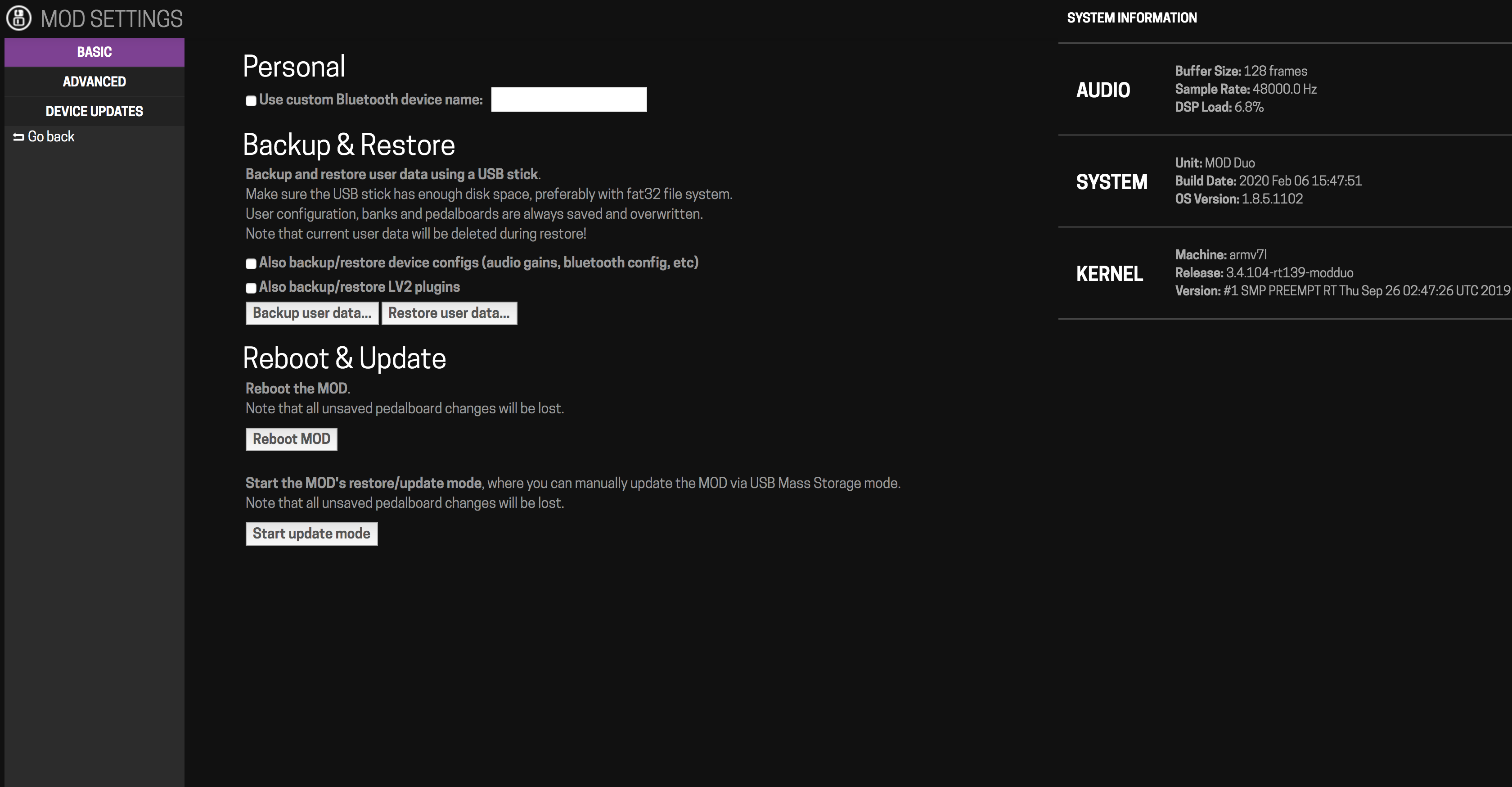

Make sure the device software and plugin are updated.
This feature was introduced in v1.8, and plugins were changed to adapt to it. So updating is required.

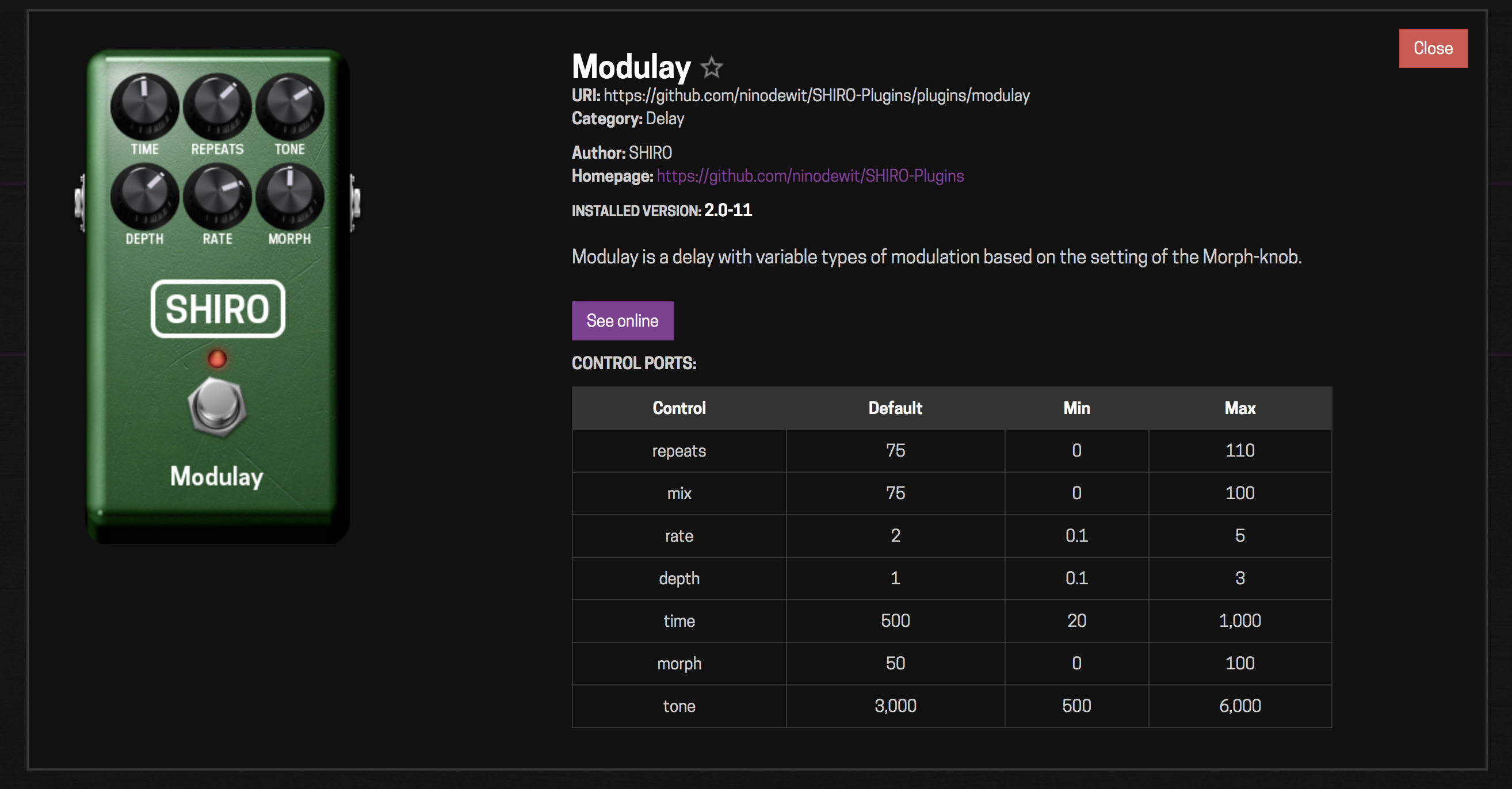

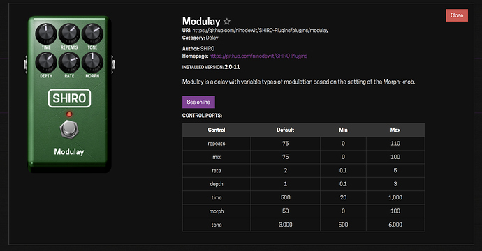

Yes, mod duo and plugin are updated.
I don’t know if you understood but I already had the updates made when I posted the problem on the modulay.
I am very disappointed with the mod duo, it is not a reliable solution. Modifications were done in the firmware that threw all my pedalboards in the trash. Time functions have stopped working and the updates do not solve the problems.
That’s strange because I checked my system settings and Modulay, (which I had to update today) to see if they matched yours and now they do. I can see the the checkbox for “Translate value to musical tempo” on my Modulay Time parameter. Did you reload the browser or reboot the Mod Duo after an update? I find it odd that it doesn’t appear for you. Hopefully it’s not some browser cache issue or something like that.
I cold try cleaning the cache next time I work with Mod Duo, but every other features works, so it’s a shoot in the dark. I passed directly from the version 1.6 to the version 1.8, can be that the problem?
