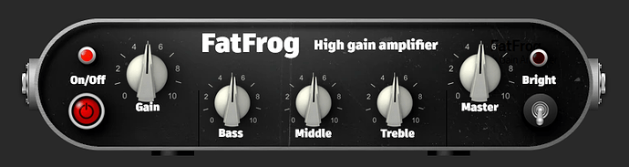

A small update on the FatFrog, here is a screenshot from the mod-sdk (all webp based):
@brummer ok. Just give me a message when to start.
FatFrog looks amazing! :smiley:

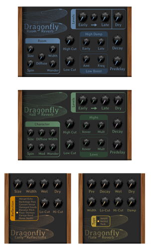

So I got the bug to play around in Inkscape, and decided to mock up a GUI for the Dragonfly reverb series - which isn’t even available in the beta store yet lol.
I just grabbed a random knob, so I’m not entirely happy with that, I think metal knobs might be better with this aesthetic but I’m not sure.
Also, the two smaller units - Early Reflections & Plate - I kind of fizzled out so didn’t take care of some of the minor details like shading the ‘paint’
With the exception of the knobs and the wood grain, this is all done with pure SVG.
Thoughts, criticisms?
Personally, I feel that it looks cool and I like the “Moog style” with the wood and so.
Not sure if this part on the knobs also makes you unhappy with them, but the little pointer for the value having the same color of the text feels a bit too much information and kind of boring. I would go for a slightly different color on one of them. Maybe keeping the text white and even leaving the graphics in the same color.
I kind of agree on the knobs. Different types for the big and small ones would be nice. Layout and graphics wise this looks great though!
I love the Moog look! Now I want to try out the plugin in question :slight_smile:
Nice work @FistfulOfStars I kinda agree with the other guys. I’m not that into the knobs but I like all the stuff that you did. I find these knobs to be overly detailed. I think a much simpler one would be nice, just a circle with a line. If the knobs were also vectors that would be ideal. I do like the wood grain but I think even without that texture it would be a nice clean design and would be entirely SVG. The font looks a little bit old school to me but I don’t mind it. Really nice work on the graphic!

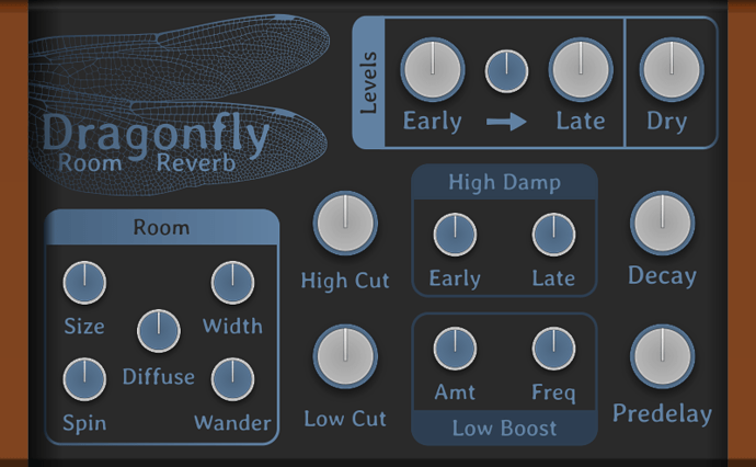

So here’s my first attempt at custom knobs. Is this an improvement, or a step back?
Also, this version is 100% pure svg.
I’m having an issue where if I open the svg directly in Firefox, the text isn’t positioned correctly. I need to figure out why. Any graphics pros here with some advice on that? Do I need to convert the text to paths to fix this, and to avoid having to embed the font as a binary value?

For me it is, to be honest, a step back. Why not using the buttons before and making the pointer in white colour?..
…and yes, you must convert the text to paths. If the text is text, the settings of the browser can rule.
I’d only change the notch color to the same color of the rings in the big knobs.
White on light gray is not very readable, expecially if you don’t zoom on the plugin.
I think this is almost a perfect example of how a vector based GUI should be! everything is nice and clean, easy to read and a great balance of aesthetics and information density!
Really nice work on the shadows and highlights considering it’s all vectors! you must have used a lot of gradients!
I think you completely nailed it :clap:
Agreed. It’s always good to convert text to paths. We got a lot of device prototypes in the past where our laser engravings saying “MOD Duo” or “Expression Pedal” were engraved in Times New Roman or even Comic Sans! because the manufacturer’s machines were missing the fonts. It was very annoying but at the same time kind of hilarious
That’s probably a good idea. It would give it more contrast and make it easier to read. You could perhaps make the line on all the knobs slightly thicker too
It was requested that this design be pure svg, and also I agreed with a previous comment that it was “too detailed.” I had started out with it being that with a white pointer, and wasn’t really a fan of it myself.
What about it specifically is the issue? I’d love to incorporate some ideas to make it better. I was kind of leaning toward a metallic style knob, do you think a bit more detail in that direction would be beneficial, or no?
Your point about the white on grey is well taken. I’ll try the ring color, but I’m already concerned about it being too monochromatic. Will have to play around with it more.
