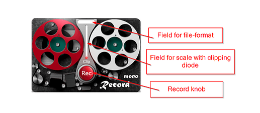

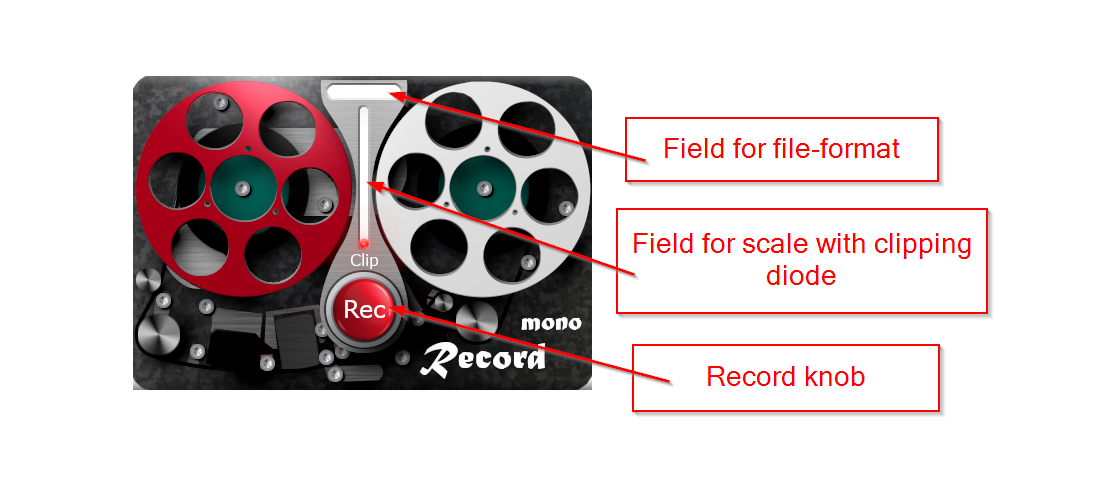

It took a bit longer because I had too much work last week. But here is my proposal for the Record mono and stereo. It must be a bit polished still…

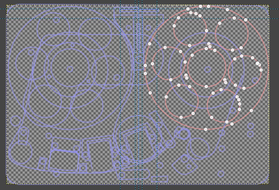

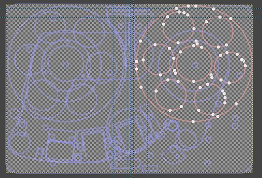

I found a method how to save all shapes in Gimp in paths. These paths can be easily imported to InkScape for further editing. I now could easily create a vectorized version of this as well.
That looks familiar. Is it based on the Nagra SN?
wow! You recognized it! Yes, indeed! It is based on Nagra SN. But it is 100% painted. No photo included. And it is a bit different.
LOL yeah, I follow @heinbach on IG and he posted photos of one a few weeks ago. It’s a beautiful piece of machinery. That price tag, though.
This looks awesome. Defiantly nice interfaces for the recorders. And if you be able to create a SVG from that, we are fulfil the needs of the new upcoming artwork guideline (at least I guess so) :grinning_face_with_smiling_eyes:

Cool, thanks a lot for the compliment! I will try to create a vectorized, scalable graphic now. It certainly will not look as nice as the pixel graphic because lighting etc. is more artificial in vector graphics. As well no pixel graphic should be used in SVG due to scalability. Thus e.g. the housing will be not as nice as it is now. But let me try. We can decide which one to take by comparing both, the pixel and the vector graphics.
One question: You will need the red Rec-button and the red diode separatls in two stages on / off, right? Do you need something for the scale and the field for the file-format as well?
Yes, easiest would be a horizontal sprite, even if there are just two stages.
The record button looks really cool.
File-format field is based on some CSS rules, so we don’t need a image for that one, for the scale it used currently a png image which I’ve generated with cairo/C++. If it comes handy to you to create a other one, that wouldn’t hurt, but is not necessary, we could reuse the old one, or I generate a new one for the needed size.
The current used MOD UI images and definitions you’ll find here, so you could have a look on the CSS file and the javascript to see how that worked.

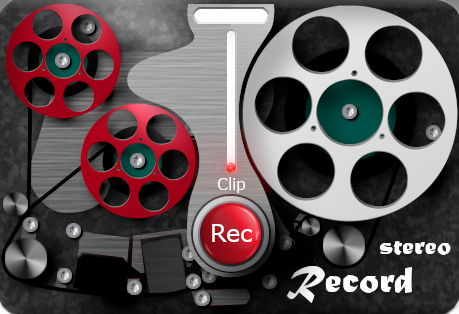

@brummer The sprites for Record plugin are finished. I created:
  • Two background sprites for mono and stereo Record in the file-formats PNG (165 KB) and WEBP (39,4 KB)
  • Rec-knob in the file-formats PNG and WEBP
  • Red diode in the file formats PNG and WEBP
  • Scale im file format PNG (WEBP has been blured because of compression)
The scale has 61 stages. The size is 610 / 124 Px. The size of the scale itself is 8 / 122. There is one transparent pixel on the left, the right, the top and at the bottom of each of the 61 scales. The row of scales thus starts with one transparent pixel, then 8 Pixels of visible scale, then 2 pixel transparent, then 8 visible Pixel, then 2 visible etc. I hope everything is fine with this scale. Please let me know if correction is needed.
The suff can be downloaded here.

I would say though in terms of the values I think a lot of people are expressing in this thread, the tape recorder design is a bit in the opposite direction. It looks cool don’t get me wrong. I think for a utility plugin like this, it has a lot of unused space and shows very little information. It’s mostly aesthetics and limited function. Also in my experience, reel to reel tape player style GUIs are usually used for Tape Saturator type plugins so it might be a bit confusing to see this for a recorder
I imagined a GUI like the ones used for the Audio File Player and the MIDI File Player for this kind of plugin. I’m not saying this to dis you in any way, I really don’t want to discourage you at all because you are doing great things here. I just want to try to steer things more towards practicality a bit

I hear that kind of argument often in discussions about skeuomorphic GUI’s, I always wonder what you expect to do otherwise with the “wasted screen space”, blanc screen or a nice view on a background image or what?
So in a daw I don’t think it matters because each plugin has a window but on our platform the user needs to assemble multiple plugins around each other and route them all together so unused space on a plugin GUI means that more space needs to be made on the board for that plugin and means that you need to be on a further zoom level to route things which means that all of your controls and visual information is harder to read because you need to be zoomed out.
Basically I think it’s ideal for the user if they don’t need to zoom in and out so much
