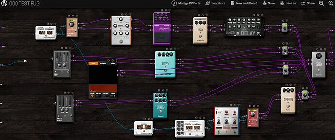

I just noticed one thing, I didn’t know that when you connect a keyboard in USB there is no need to connect the MIDI patch, that is to say that as in my screenshot below, I can play with all this pedalboard as is. The “Hardware All MIDI IN” can only be used with a connection to a MIDI device? Thank you.
That is the “aggregated” midi mode, where all midi ins go through the same single cable, same applies to midi out.
You can click on the “MIDI” button in the bottom if you like to change to “separated” mode, which allows to connect different MIDI inputs to different things.
The default being “aggregated” just makes more sense, and it is easier to get things to work.

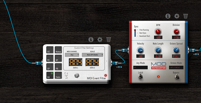

So the workaround from the other report (MIDI filtering sysex) will save me! What’s odd (and I’ve run into this before) is that MIDI was still getting sent to the arpeggiator plugin even though it appeared that there were no MIDI cables connected to it. The author of the previous report was experiencing the same thing (I am also using USB) and it definitely happens sporadically.

Filtering sysex before the arpeggiator totally works as a workaround!
