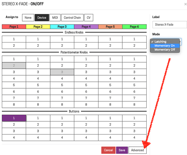

So I just propose (again) that any parameter thats a toggle switch that you’d map a footswitch to, has advanced options to change from “toggle mode” (the default), “momentary on”, and “momentary off”.
I actually think for the DuoX with all those pushbuttons, this will become even more yearned for.

We hear you!
For the Duo(X) this will most likely be possible in V1.10.0 :slight_smile:
For the MOD Footswitch, it will probably get an update around the same time the expression pedal is released.

I’m guessing this didn’t make it to the 1.10 update. Is still on the radar for people?
the momentary mode options are for sure in v1.10

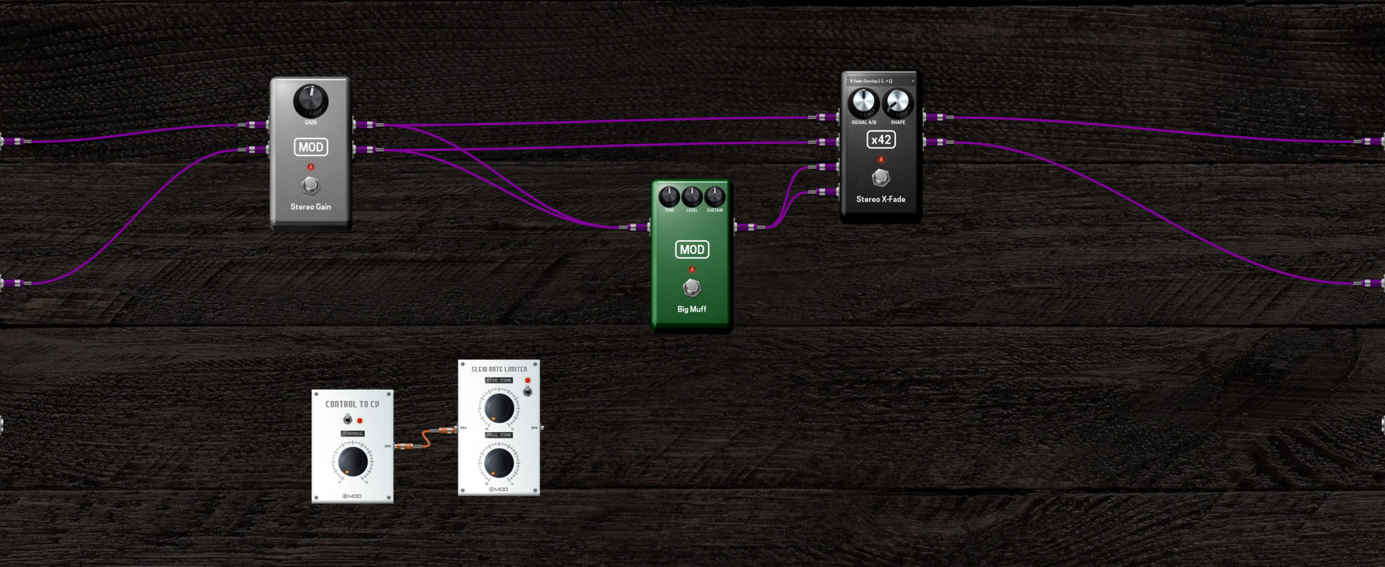

Here’s another feature request… would it be possible to have a momentary switch that would roll on and off? So basically, you press one of the buttons and then it starts to fade on or off based on the defined time…
I think this one is possible using CV and some creative routing
Signal → ——— [X-fade] ————————————————————————— Out
               \___ [Plug in] (always on) __/
CV (mapped momentary) → Slew → X-fade blend (via CV)
Thank you @danmh… I’ve never actually used the X Fade before and I really can’t figure out how it works… and could you explain how to use it via CV? Maybe a starter pedalboard? Thanks so much
Give this one a try @JEL
Hope it helps :slight_smile:
