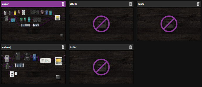

There is strange behavior with pedalboard naming. My default pedalboard received the name from my other pedalboard, and now I’m not able to change that.

There really going something weird with the naming of pedalboards when MDX connected to PC. Now I’ve found that if I turn on MDX when it is plugged in USB, my pedalboard instantly receives the name of the default Pedalboard. It looks like how system default board received the name of on my experimental “exper”. Which now always assigns to last loaded board.
very very odd…

Can confirm. Yesterday i created a pedalboard with the name “logic”. Today when I turned MDX on (connected to PC) in the web GUI displayed the name as it is Default pedalboard name (“EXPER”). And at the same time, on the device screen of MDX name is “logic”. I will try to flash pedalboards and restore them.
UPD: Well, i just reflashed everything. After erasing all pedalboards Default is Default. BUT. When i restored everything back, again “Default” is “Exper” and this naming issue still present.
