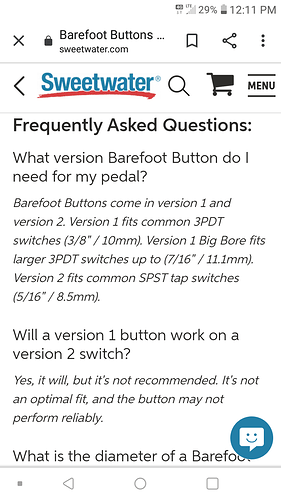

Barefoot Buttons make a version 2, that are 8.5mm, but i guess that may be too small as the mods are 8.8mm?
Barefoot doesn’t recommend using the larger 10mm on the smaller switches, but good to know you have used them and have had no problems. Thank you!
