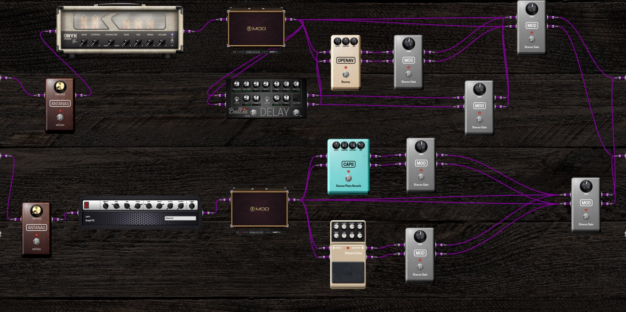

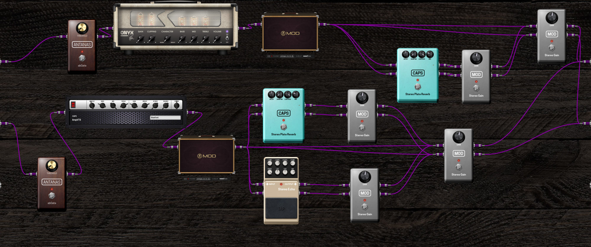

I did further tests today and got several errors most seemed to be centered aroud one pedalboard but randomly others. One interesting feature is that I noticed that the pulsating LEDs and audio was at a different tempo for different pedal boards which made me think that this could be caused by a plug in perhaps a delay pedal which may explain the tempo difference.
I have attached screen shots of two pedalboards which are named A & B, Pedalboard A is the one that seems to error most and B being one of the random selections. Pedalboard A LEDs and audio pulsed quite fast while pedalboard B pulsed a little slower. Note that the Stereo Echo plugin is used in both and the delay time settings seem to match the difference in the tempo of the pulse, this may be a coincidence but could it be the cause?
If so then the midi selection may be a red herring, I don’t think it has ever produced the error when selecting within the GUI but my next step is to see if I can create the error using footswitch selection.
I can now confirm that the errors occur when selecting pedalboards via foot switches so the problem is not midi related as I first thought. If it is a plugin causing the issue then the randomness could be explained by the fact that I have some of the same plugins on all pedalborads. Although the fault occurs on random pedalboards the first screen shot above is the most common pedalboard to create the fault.

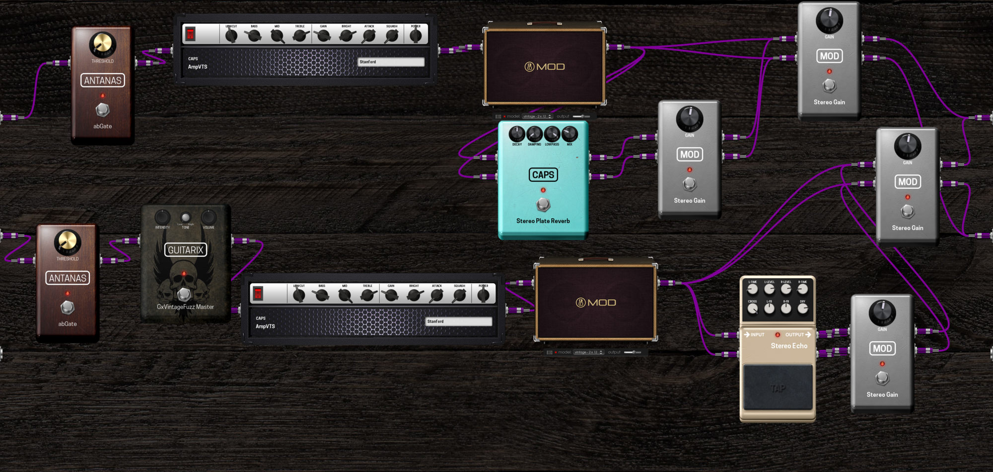

OK I have shared 3 example pedalboards (thanks Elk_wrath) but note that this bug shows up randomly on any of my pedalboards but these 3 examples just happen to be the last 3 that triggered the bug but they don’t always trigger the bug.
