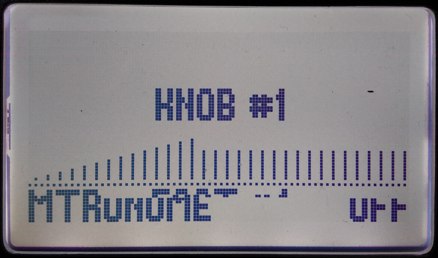

as in v0.12.2, the Duo display1 has some troubles when I load a new pedalboard
This is the normal display for the click pedalboard:
and with the defect:
This issue is not specific to this board.
you can also see on the first picture that the accentuated letters are not displayed like the second letter in “métronome”. The problem is that I can’t save the name of the on/off switch in advanced parameter, even after having changed of board or reloaded the MOD-UI. The only solution I found was to delete the board and create it again.
the choice for a new pedalboard in another bank is not possible with the knob2 during editing with MOD-UI. The normal behaviour of the knob2 is retrieved after disconnecting the Duo from the PC.

That’s a known bug. You can track it here: sometimes display image is cut off · Issue #10 · mod-audio/mod-duo-issues · GitHub
Djiboun:
Accentuation is not supported, but of course you should have no problem trying to save it. We will fix it.
Not a bug. That’s how it works today. Next update you’ll see an info message when you try to access banks and UI is connected. Also reported here: knob 2 long press to select banks not working after changes in banks · Issue #39 · mod-audio/mod-duo-issues · GitHub
