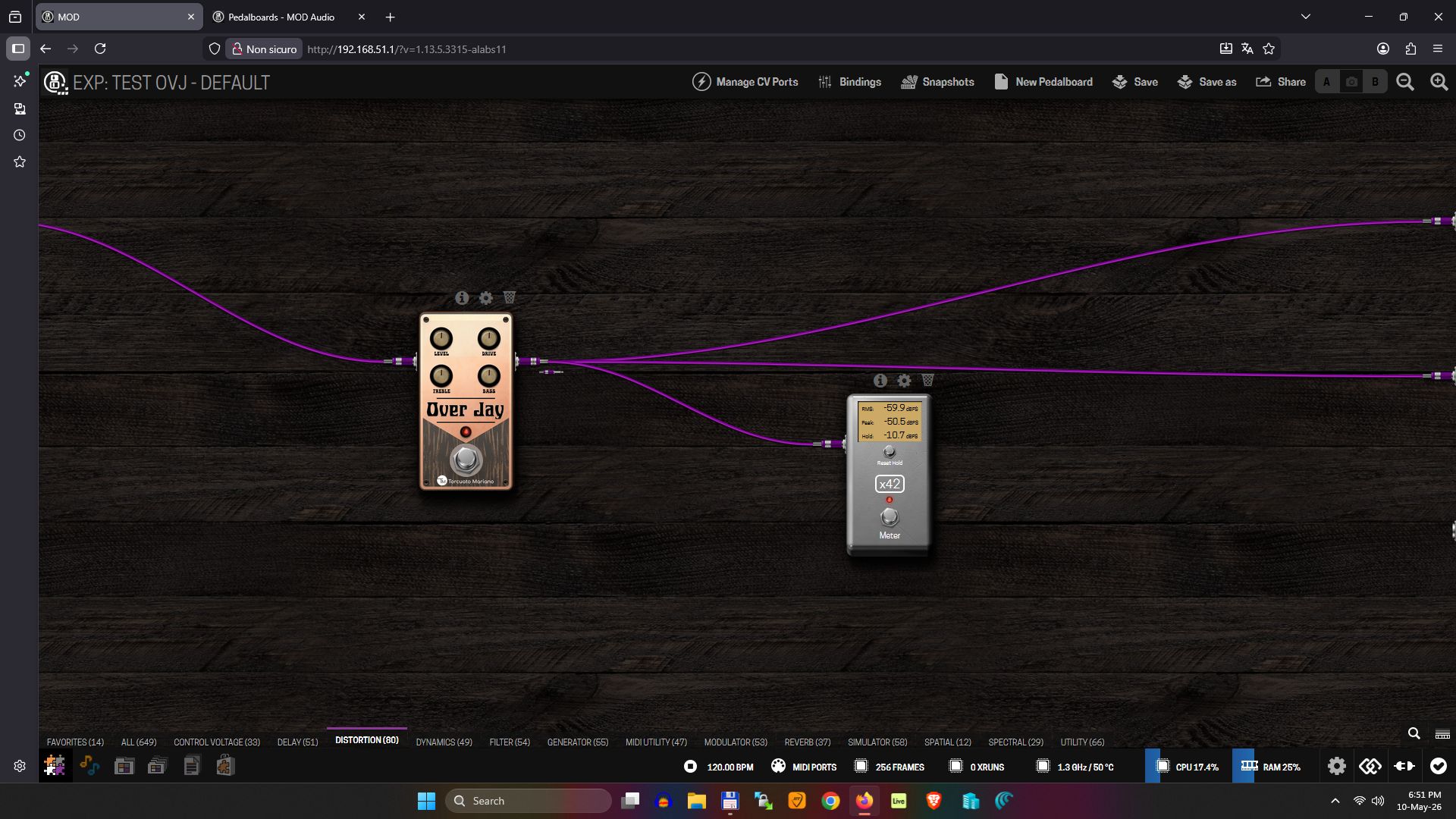

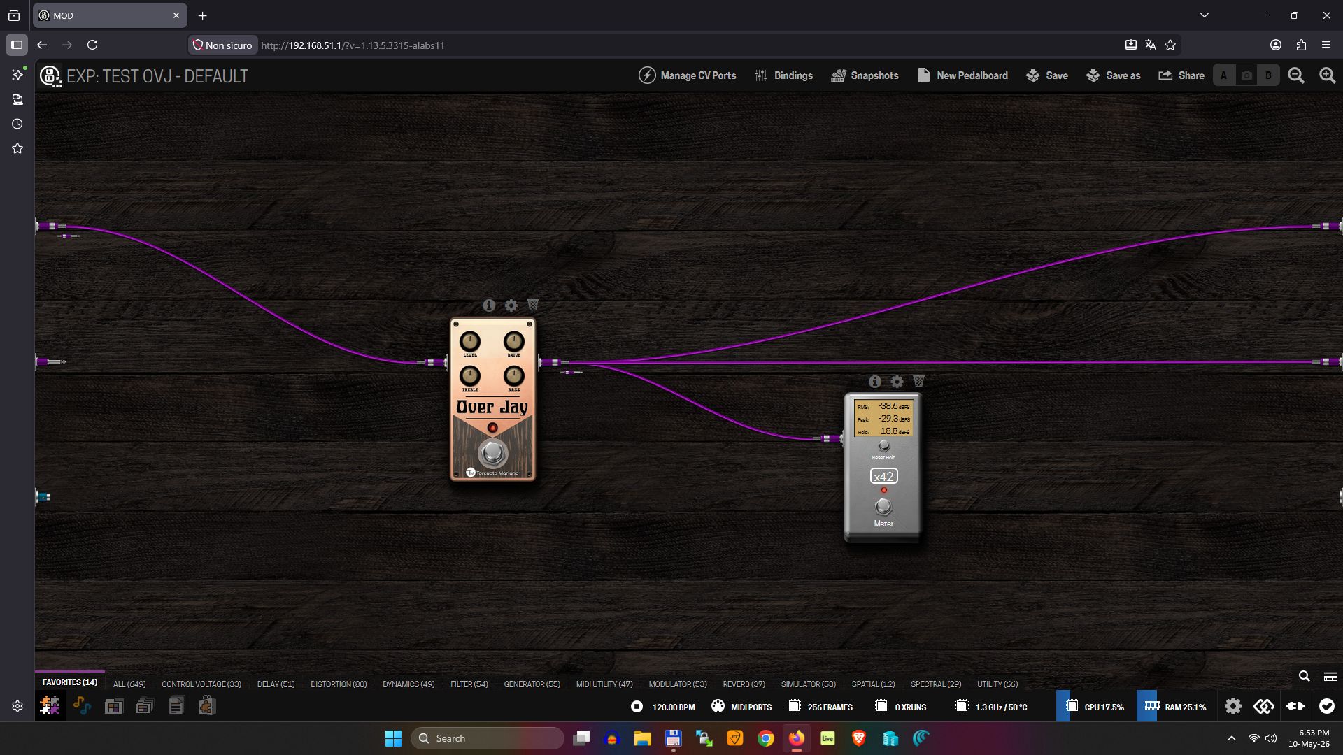

Hi All,
sorry for the entropy, but I managed to perform a test and I have to confirm that the updated version of the plugin is way louder than the previous version.
The first screenshot runs version 1.0-7, while the second was taken with the latest version: same guitar settings, same plugin settings (default), same power chord.

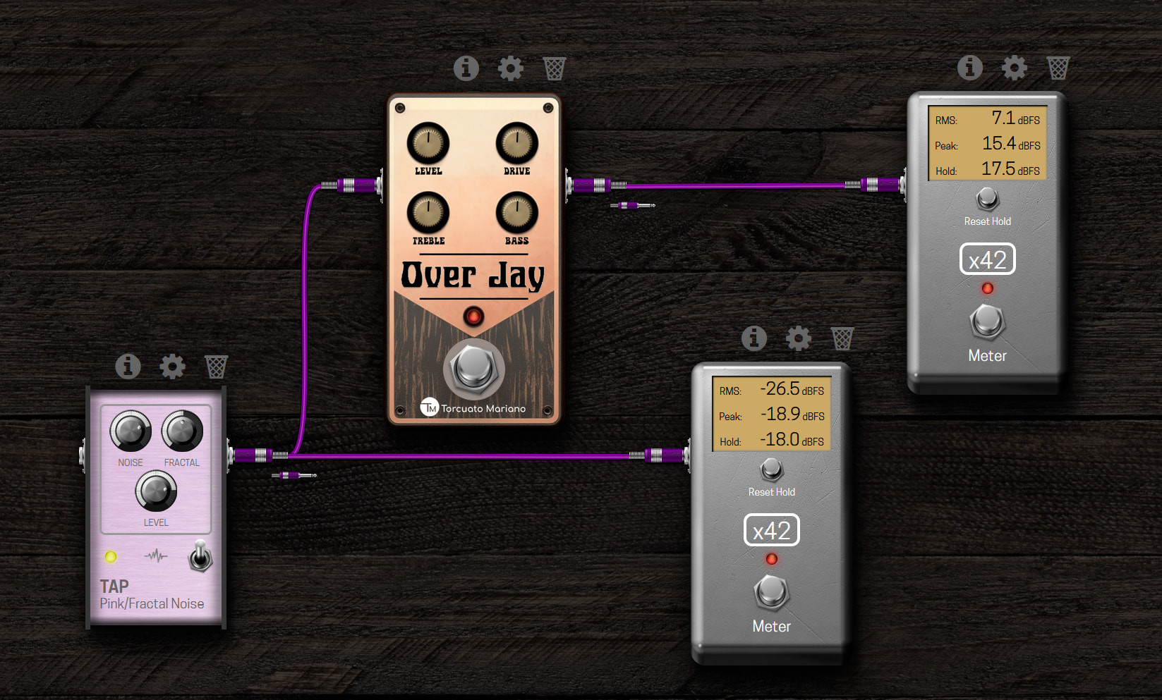

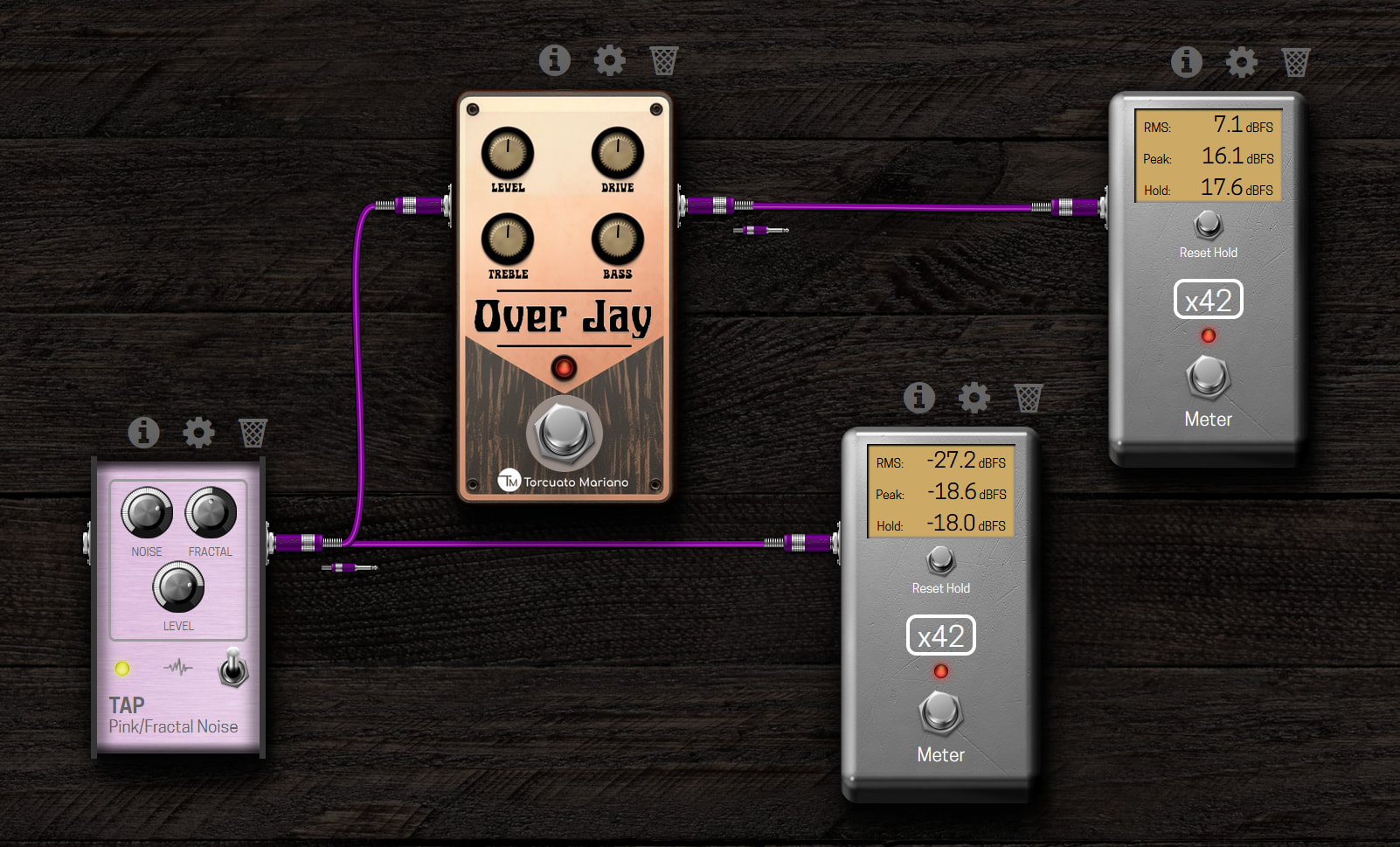

I’ve did a test with both versions using a pink noise generator at -18db and hera are the results. :backhand_index_pointing_down:
sadly such bump in volume is not unusual from some of the plugins coming from this collection.
when we ported these to the darkglass anagram marketplace we ended up using -45dB attenuation for the “lead trilogy” and -35dB for the “plexi breed”. I mean attenuation in order to achieve unity-gain on default values, because some of these are really loud yes.
