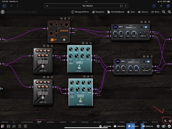

If you have verified install, here is what you do from the board construction page:
Click on the icon to the right of the magnifying glass.

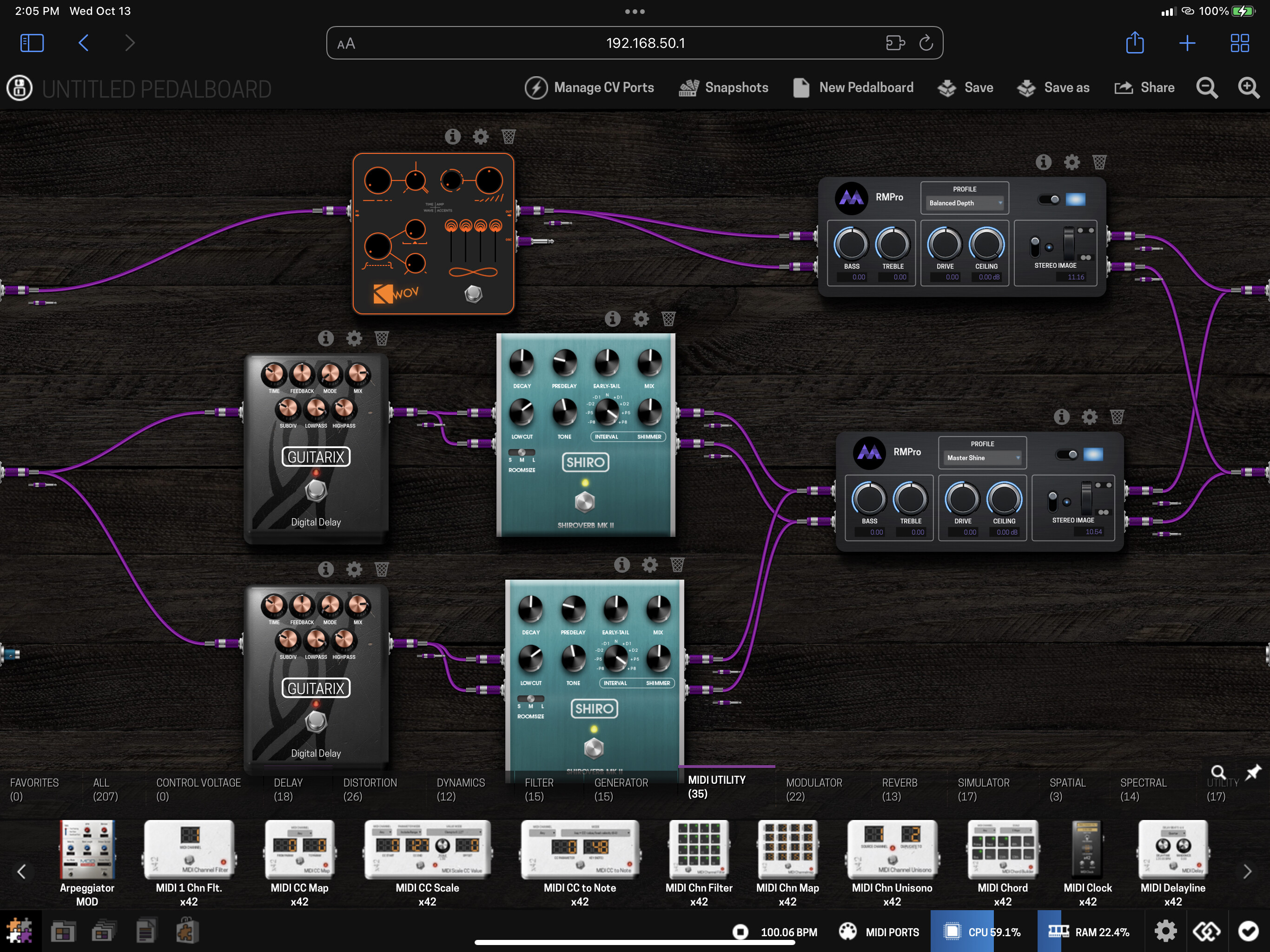

When the plug-in list pops up, select “Midi Utility”
It should pop up in that list.
