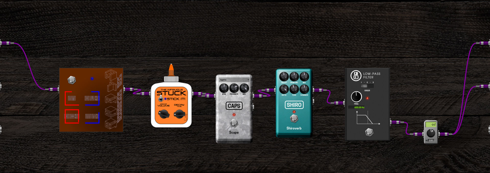

I have a pedalboard which produces a really irritating earpopping sound every now and then, when loaded.
Most of the time it works fine and it is one of my favourites. Used it for intro of one gig.
How to reproduce
after loading it several times (between 5-10 times) it will create a very disturbing sound that will onely stop when changing the pedalboard.
Be very cautious with your gear and ears when trying it out!
Couldn’t figure out what causes it.

Created and used on Mod Duo with various releases (1.9 , 1.10) always with the same habit.
Likely caused by one of the plugins. They are up to date, right?

@falkTX I now found out that the update all function didn’t work (got the message that all plugins are up to date which isn’t the case), so I updated every plugin that’s in the pedalboard “manually”.
I tried now loading the pedalboard a lot of times and also loaded several different ones in between and I couldn’t reproduce the bug, so maybe updating the plugins did do the trick. I will observe this and report, if the bug occurs again.
