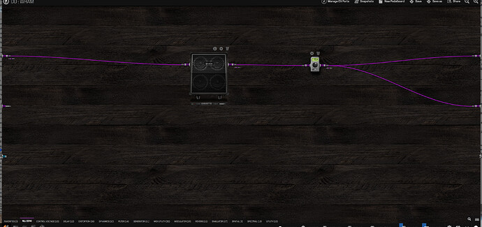

Hello, everything is in the title :slight_smile: I have crackles when I use the dwarf mod even with very few effects loaded (see photo).
I feel like this happens more when I am logged into the GUI. Do you have any idea what caused this?
