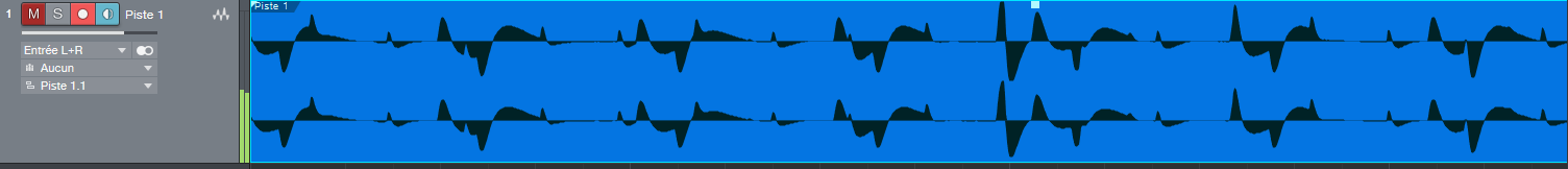

Sorry to bump up a several months old topic, but I seem to have the same kind of problem on my DuoX: low frequency pulsating noise, one every pedalboard. When I turn the infinite encoders, it gets worse (like a scratching noise).

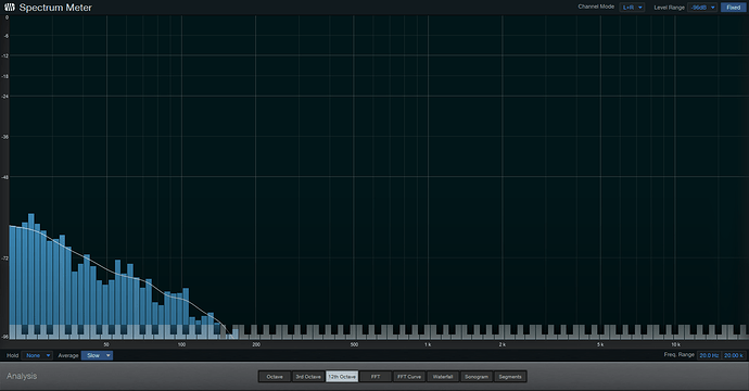

I never noticed this before because I used it in a rather quiet environment, and never tried to record anything with it, but it really affects the spectrum between 20Hz and 200Hz.
Here is a picture of a spectrum anaylsis:
The sound is not constant, it’s like a regular fast beat:
