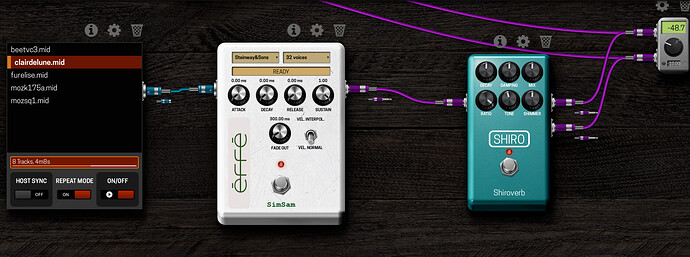

Got the plugin running..
With just a few tweaks I am able to make this work with v1.10, still leaving the 3 hand-picked and refined SFZ files as-is but allowing them to be uploaded by the user with the new file manager stuff.
So the plugin loads whatever possible. It is great to have the feedback on loading vs load error vs load ok. Even better would be if this is extended to display % of loading status.
Now.. while I have this working on the slowest possible unit (kickstarter Duo, with nand) and the plugin actually works, it takes a looooong time.
The plugin reports
Finished loading 85 notes in 340993ms
Which is around 5 and a half minutes.
Uploading all the samples also takes a long time (it is 700Mb upload after all), and only 1 instrument fits on the kickstarter Duo. But indeed all works after everything is in place.
Compared to the most powerful MOD device that exists at the moment (Duo X production units), uploading the 700Mb pack takes around 30s, and loading the full thing in the plugin around 5. :scream: :rocket: :rocket:
