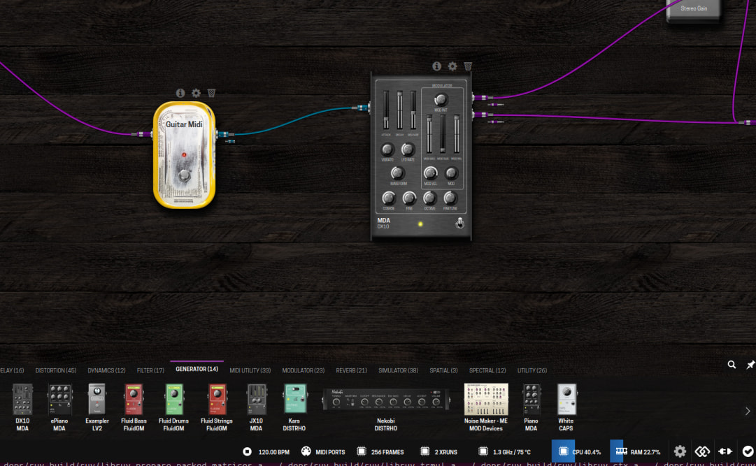

It works fine with synth plugins.
However, with piano plugins like Plugins - MOD Audio, some extra notes are occasionally triggered, which can be a bit distracting.

The extra notes can be mitigated with the onset threshold parameter. The model is pretrained currently only on synthetic guitars. In June I’ll run a training round with real guitars for fine tuning. That will improve the situation
