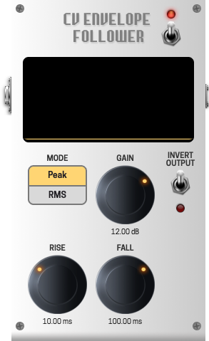

Controls:
- Gain controls the audio input gain. You can use this to compensate for gain increase or loss due to changing the Rise and Fall times.
- Mode controls how the audio input amplitude is tracked. Peak uses the absolute peaks of the incoming signal and RMS takes the average amplitude over a small period of time.
- Rise determines how much smoothing will be applied to an increasing value.
- Fall determines how much smoothing will be applied to a decreasing value.
- Invert Output will invert the cv output signal. Instead of going from zero to one it will go from one to zero. N.B.: the Rise control will now effectively control the falling time. And the Fall control will now control the rising time.
