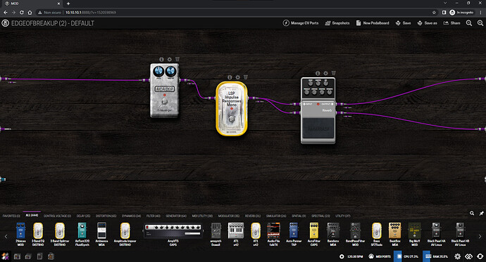

- intro: edge of breakup model plus custom IR Fender Vibro Lux 68 via lsp plugin + Rakarrack reverb (Default, just a bit of mix adj)
- rythm: rock rythm model plus custom IR Fender Vibro Lux 68 via lsp plugin + Rakarrack reverb (room1)
- solo: rock solo model plus custom IR Fender Vibro Lux 68 via lsp plugin + Rakarrack reverb (Default, but almost 100% dry)
No fx from DAW (I used Reaper)

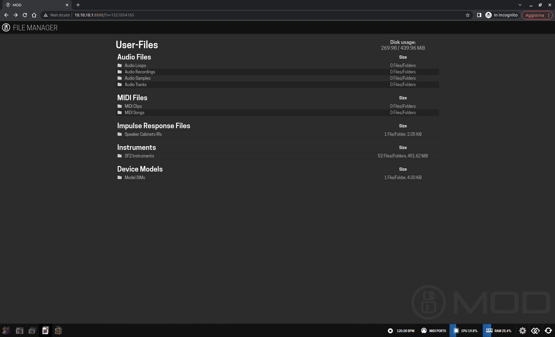

When I try to add the plugin to pedalboard I get
DEBUG:root:[host] received as response <- 'resp -102\x00'
but I suppose it is because I haven’t set the filesystem stuff yet. I’ve created this folder
/data/user-files/Model SIMs
but it’s not shown into File Manager. I suppose it should be configured somewhere…
