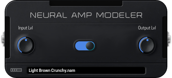

Neural Amp Modeler
The NAM plugin comes to the MOD platform!
One of the developers contributing to NAM (Mike Oliphant) made an LV2 version in order to have a version of NAM working for LInux, less features compared to the original but the important part - loading nam models - is fully working.
MOD assisted in getting this LV2 plugin version working as expected by most hosts, and after some testing we are pushing the plugin to the store!
The plugin requires the latest v1.13.2 for being able to upload NAM files on the correct directory.
Note that old regular “heavy” models do not work, models must be of nano type.
Tonehunt uses the #nano-mdl tag for this purpose #nano-mdl Models | ToneHunt
We uploaded a few models of this type already to it.
Enjoy!
PS: more content related to this plugin coming very soon
