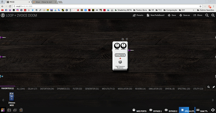

Great script! I got it running here and could record some stuff from mod <3! But now when i look to my pedalboard it looks like this (it should have 4 plugins connected to each other), even after restarting mod, and its failing to connect to MOD Cloud too:
When you say ānowā, you mean that your pedalboard started looking funny as soon as you ran the script, or after you recorded your stuff, disconnected/reconnects etcā¦? If you give more details about the sequence of events, that might help understand what happened. Also, did you stop the script ? restarted your PC etcā¦
Which flavour of Linux do you run ?
Sorry for being vague. By ānowā i mean after running the script (I had some trouble at the beginning because the script wasnāt coming back from the ssh, but after trying and fixing it I tested right after a reboot running without stoping) and doing some recording, when I tryed to change the pedalboard i noticed that. Im using an Archlinux,
Better to wait for 1.4-rc1, I added some minor things and checks that help this case.
