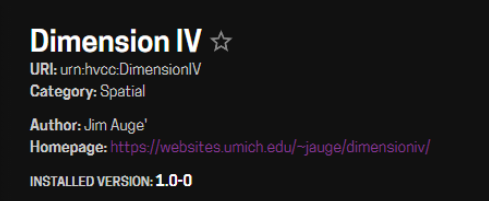

I understand that the text should read “This specific page is meant for Dimension IV by Jim Auge’ with Spatial category.” But instead I get this:
That information does show up in the plugin itself:

I didn’t notice before, but the same happens in my shared persistent builds. But for me personally it isn’t that big of a problem as long as the build itself displays the correct names.
OK, it’s just that the text works correctly for me when I process a .pd so maybe it’s not my repo or .mk file but rather the buildroot version of the page is incorrectly formatted.
It will just be a little confusing for people when you share the link for plugin made by of the category. But not that big of a deal I suppose.
I just wanted to make sure there wasn’t anything more I could do at this end to correct it.
