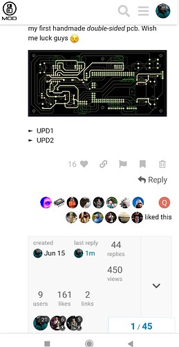

Seriously, why can’t I edit my own topic (this one) anymore? Is there a limit on the edits or something? @jon, maybe you can have a look at it?

I want to edit the body of the post itself. Clicking on the three dots does not give me a ‘pencil’ to edit the post…

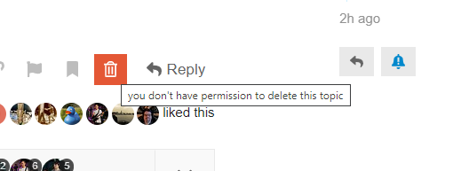

Here's what I see
I still think this is some kind of access rights issue, also because of this:
[details=““You don’t have permissions to delete this topic””]
[/details]
Ok, the last addition to this topic and then I’m abandoning it - because I can neither edit nor delete it. I’ll start a new topic on this device I’m building.

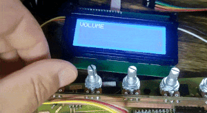

Anyway, here’s the last breakout board with six pots on it. Next thing is preparing (milling, drilling) the enclosure, as discussed above.

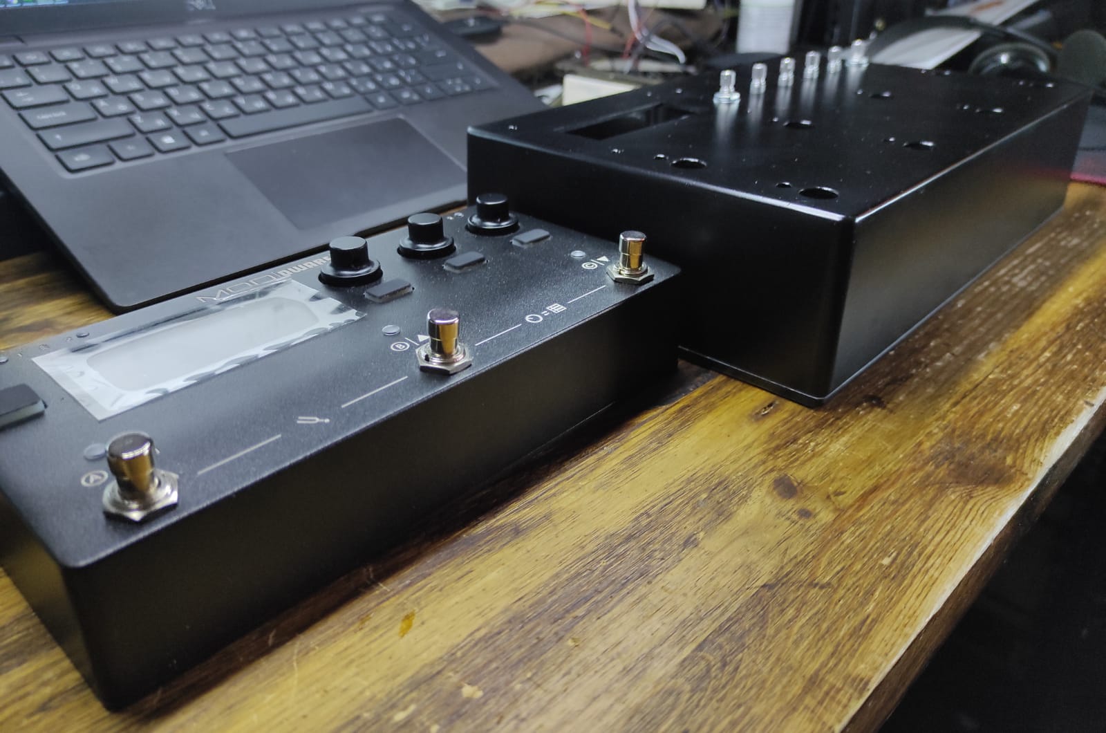

A sneak peek on the chassis…

this looks really great - is it bigger than the dwarf?

Thanks! Yes, it is way bigger, and to some extent it is by design, but also a bit unfortunate: for one, there are two rows of footswitches, four switches in a row, so, naturally, the box must be wide enough to accomodate for stomping without accidentally touching the other switches; on the other hand, the encosure is 65mm high, way higher than the Dwarf, and I don’t like it, but I couldn’t find a slimmer box anywhere for the life of me (I got this one off AliExpress, of course), and I’m too lasy to mess around with sheet metal, or to have the chassis made to order.
The ‘guts’ of the box are quite primitive in design though (I didn’t use any SMD components, that’s something for the next gen maybe), so they’d probably not fit into a slimmer chassis.

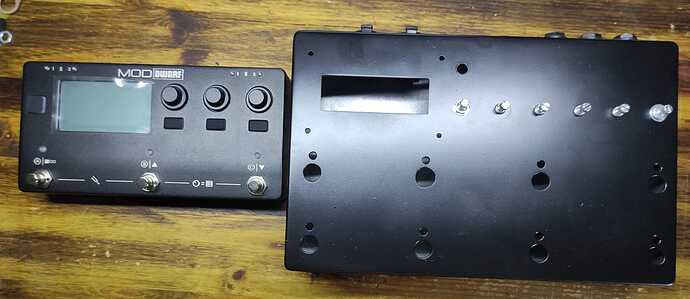

For now, here’s the comparison of the Dwarf and the Elf (as I call my box - should probably call 'em Gimli and Legolas lol) next to each other:

whoa - that is big. But looks sturdy and more space for footswitches is always a good point.
The hight would be a problem for me when pressing footswitches heel down - I always had problems adjusing to them even with the dwarfs hight when mounted on a pedalboard.
And again great stuff - looking forward of borrowing a lot of your pcb and code :wink:
I press the foot switches with the toes, not heel, so less of a problem to me. But again, this is a proof of concept for me, maybe I’ll build another one, more slim. Maybe.

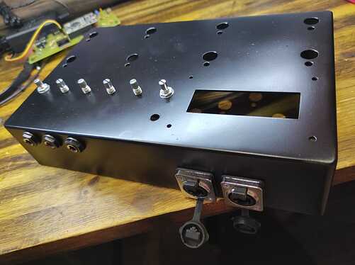

Secondly, I have finished building the hardware part of the device (a few photos attached).
The software part is 80-90% complete, I need to work on the menu, add a few features, but the most important thing that I’ll be waiting for, software-wise, is an update of the control chain protocol that would fix the issue with switching snapshots with a cc device.
