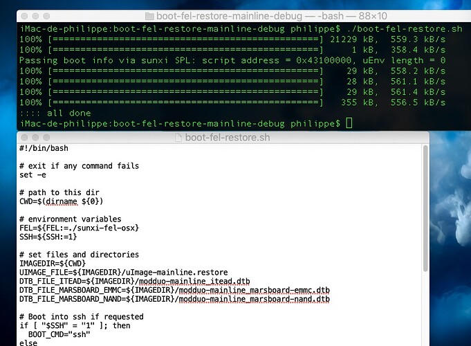

So on mac osx i moded the script and flashed with ssh1 but do i need to remove the usb and replug or just try to access to ssh ?
sorry i tried to connect to 192.168.51.1 and it ask a password i think it’s the duo interface.
So i’m in what to do now ?
