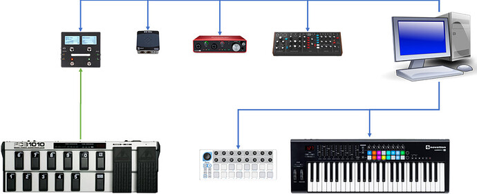

I have
PC with DAW (Ableton) connected by USB to
  • Novation Launchkey
  • Behringer Model D
  • Arturia BeatStep
  • Scarlett 4i4 (inc Midi In/Out 5pin ports)
  • Creative E-MU Xmidi 2x2 USB to 5 pin midi interface
  • Mod Duo connected via 5 pin midi to
    * FCB1010 controller

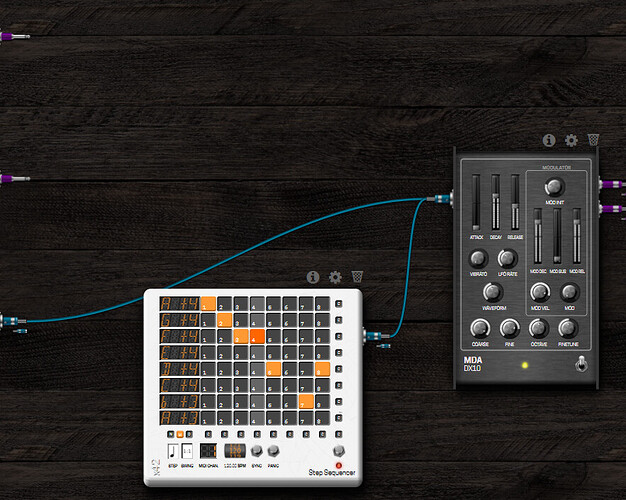

I have another issue which may be behind my problem. When I create a new pedalboard in the Mod Web interface, I get the standard patched through audio connections and an unused Midi input.

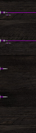

Occasionally when building / refreshing the pedal board, the Midi input disappears
For example, after refreshing the above view, I get this…

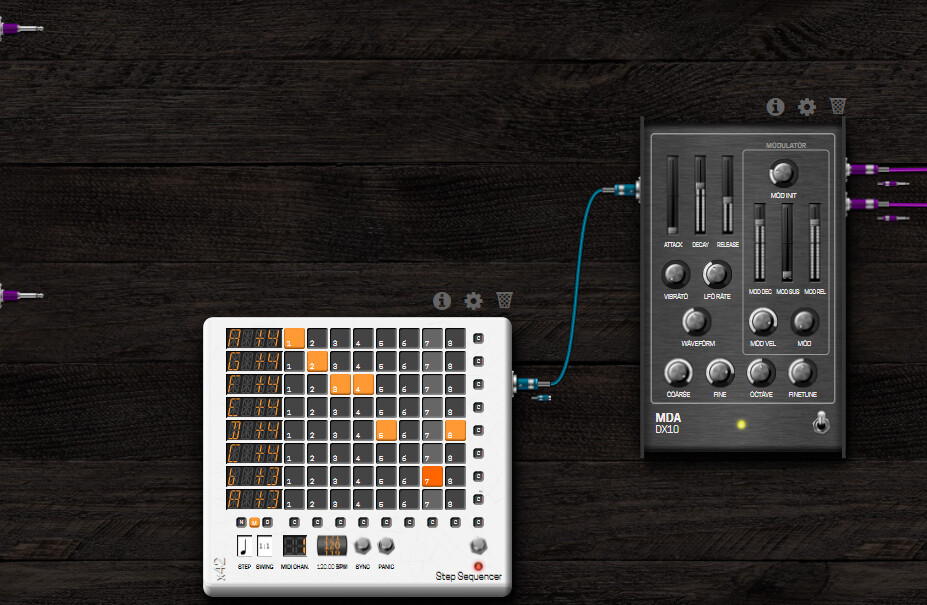

do you mean 'dragged and connected the blue midi ‘plug’ to the ‘socket’ on the synth? if so then yes (it plays notes if connected via the PC Interface and 5 pin port).

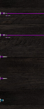

Please bear in mind that (as reported above) if I ‘refresh’ the web interface (I lose the ‘plug’ and connection to synth)
goes to this:
I don’t know if it is relevant, but seems odd!
