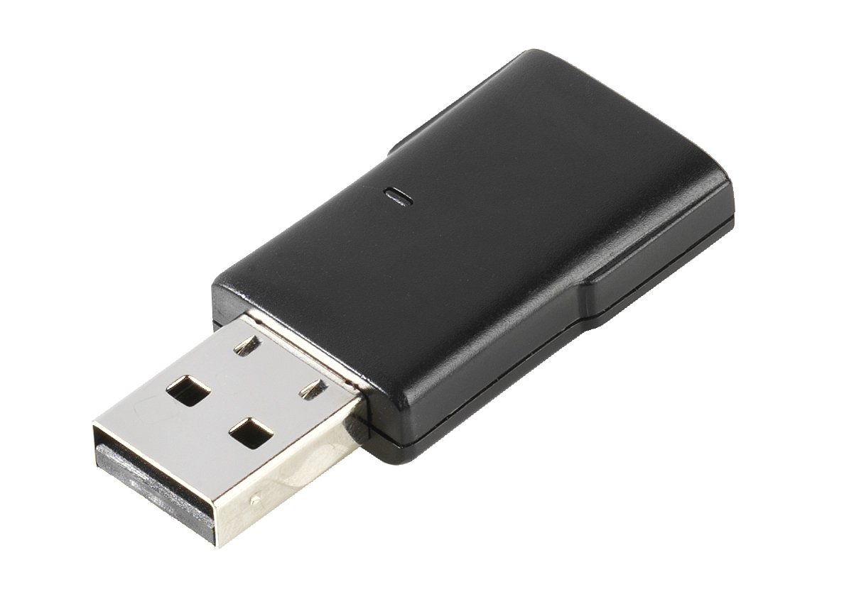

Which dongle do you use for Wifi on the Duo?
Basically the first thing I got a hold on, in our local electronics market.
Vivanco 36665
Worked flawless for a few years.
