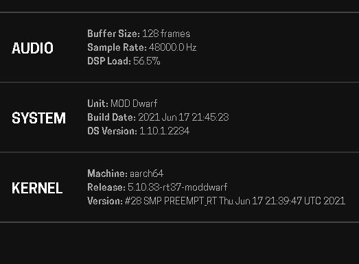

Open the controller menu (hold left knob down), navigate to Info > Versions and write down here the version.
Plug in version:0.4-12
ModDwarf details:
  • release:
Also provide some information about your system if possible.
  • Operating system: Windows
  • System version: Windows 10 (using Chrome Browser)
