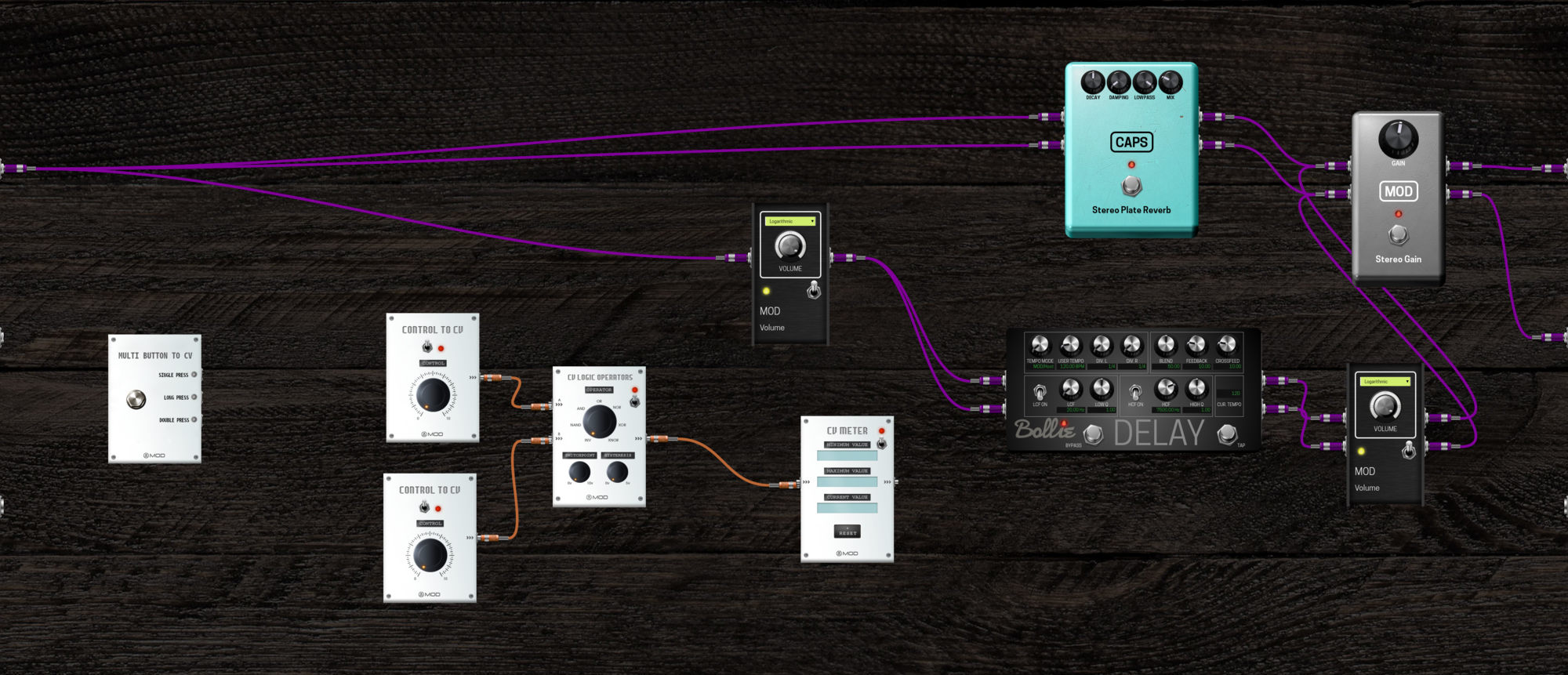

Would it be possible to implement an option to choose latch or momentary for the long press . For example in this pedalboard:
Footswitch B activates the effect permanently, C just momentarily, it would be interesting to assign only one footswitch for both functions, single press-> permanent, Long press → momentary

I think this is quite an interesting use case! We could have an extra control “long-press mode” which toggles between latching ↔ momentary :slight_smile:
