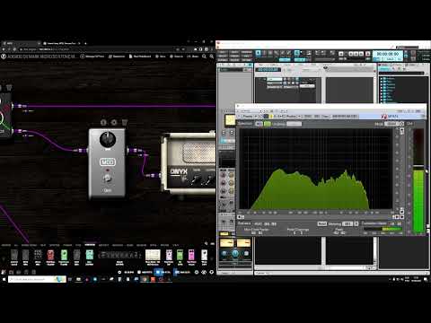

Using my devices I notice an odd behavior on the gain plugin and I think it’s related to the saved snapshot settings.
  • Gain default setting showing 0.00 Db.
  • if I turn on the plugin, +6.00 Db is add to the signal.
    When I open the user settings I can see that I have a +6.00 Db preset selected but that it is not reflect on the user settings GUI.
I have two snapshots saved in this pedalboard and I suspect that the saved state it is not reflecting on the MOD GUI.
I’ll will try to replicate this but I suspect that is related to a bug that I already reported here.
Here a video to demonstrate the odd behaviour.
Probably this is solved with last https://download.moddevices.com/releases/testing/moddwarf-v1.12.0.2934-RC3.tar which is unfortunately not yet reachable.
Let’s wait then.
