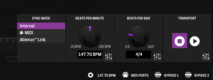

Click on the bottom of the pedalboard constructor, where the BPM is, and then enable MIDI in order to make the unit receive tempo via MIDI

I can’t see any BPM button anywhere in the constructor, how can I find it ? I see MIDI Ports, Bypass1, Bypass2, etc. but no BPM. I use up-to-date firmware.

You click on the “button” to the left of the MIDI ports.

Clicking here brings the little popup with sync mode, beats per minute, beats per bar and transport play/pause

You need to make your browser screen a little wider. Otherwise you don’t see all the buttons!
