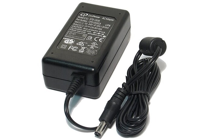

I read in another topic about some Dwarf users getting their devices noiseless by replacing the power supply so this was my first guess. Would this be a power supply that works as it should with the Duo X and won’t blow it up? The photo is a bit blurry but this should be 12V 3.0A 36W center positive.

As written on the wiki here, any power supply which outputs 12V, 2A over a center-positive barrel-type plug will be fine.
