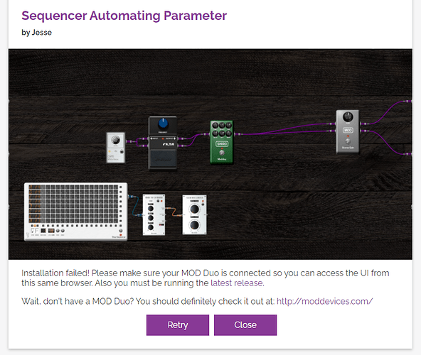

Can’t try shared pedalboards with 1.11 RC2 versiion installed on Mod Duo X
Web browser Google Chrome
- Operating system:Windows
- System version: Windows 10
1.11.0.2497-RC2 on my DuoX and loading shared pedalboards works.

Well I tried Microsft Edge and I have the exact same issues.
No way to try shared pedalboard

This is 100% a browser issue, I explained somewhere else but the gist of it is that auto-playback blocking mechanisms coming in Chrome and other browsers make it impossible to trigger an event on a browser window from the outside.
So far, things still work in Firefox, but I suspect it won’t be long.
We have this in our list of things to fix, actually something for me to do.
Likely the web gui will need to trigger a notification or message that requests user input, as typically browsers are fine letting things go through as long as the user confirms / gives access to it.
I am not exactly sure how this will work, in the technical sense, but it is very likely that a 1.10.x or 1.11 update is needed
