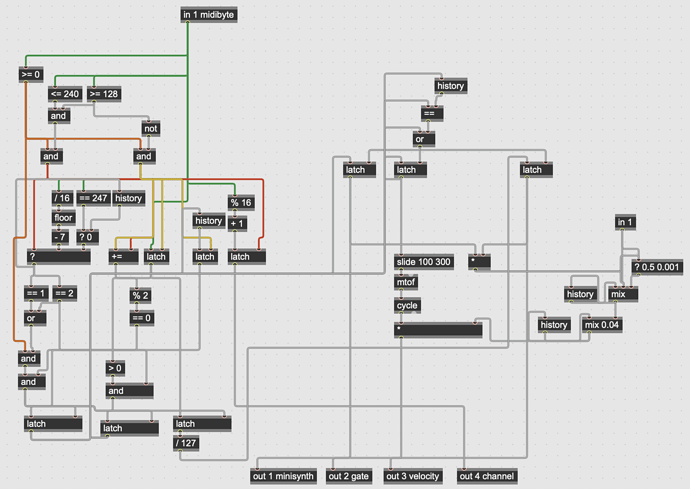

OK so, I took the Daisy Patch MIDI I/O example from Graham Wakefield and did some disassembly, snippet making, and example-ing. Included is the CPP Code Export from an altered “mod-gen~.empty_gen”, a bunch of texted [gen~] codebox outputs for reference, the original Oopsy Daisy Max Patch, and the Max Patch the MOD Cpp code was exported from.

@jon there is a [gen~] object OUTSIDE of the main patcher that is designed to take Max midi-format and turn it into audio-rate signaling by poking a buffer object. It is the object [p midimessages2signal]. I don’t believe that will be a required step along the way for the MOD environment but it is not required for this code to operate on Daisy hardware. HOWEVER, it is the thing that forces the in-line message parser to multiply the signal by 256 before the first data translation occurs in the message parser. So… there may be some message rate and bit depth things to deal with, I’m not certain.
BUT, it’s the thing that makes MIDI messages audio messages so…

HOWEVER, Referring to [in 1] or [out 2] inside of a [gen~] object these do NOT get a tilde, as they exist inside of [gen~] annnnnd inside of which everything happens explicitly at sample-rate. The goal being the entire calculation happens within a single sample unless you intentionally add delays to the signal for EQs or whatever whatever. The [in 1]/[out 2] are connectors to symbolize the ins and outs of the object-oriented codebox. The labels after the designation (“gate”, “minisynth”) usually mean nothing at all and just provide popup text to the object when you hover over a connection when connecting to it from outside of [gen~]. HOWEVER, what Graham did was add a hook to the Oopsy compile process to recgonize certain bits of text, i.e. “MIDI”, to tell them compiler something special to do with that input/output.
The instruction set for [gen~] is extremely limited compared to Max but it IS code so you can recreate any (almost) Max object inside of it, you just have to do it by hand. -Like making a toggle switch in code as opposed to just using the Max “toggle” object. Those objects do not exist in the [gen~] environment. It is purely math.
Attached is a screenshot of the most simplified [gen~] object included above that accepts 256 byte messages and outputs a cheese monosynth. (with the note off bug I got lazy about)
