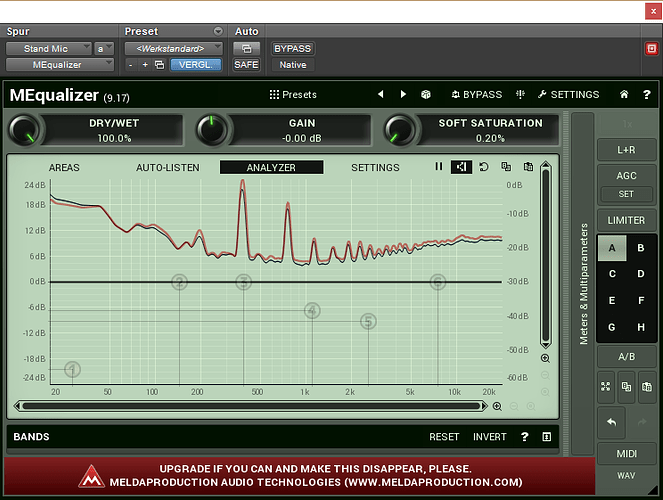

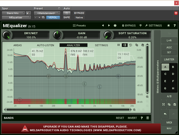

Ok, did some investigating.
DISCLAIMER: I turned the volume way up and don’t have a comparison for the noise LEVEL but i recorded the noise itself. (it’s mostly F# :slight_smile: )
the black line is output 1 and the red one output 2.
Connecting the MOD to the PC with the usb cable doesn’t make a difference, bluetooth also.
Here’s the audio. (i hope left is one and right is two but it’s possible both are one. doesn’t matter, they’re pretty much the same) Dropbox - Error - Simplify your life
What you hear is the low noise when changing pedalboards, i know this noise from my old laptops headphone jack when the harddrive was working.
AGAIN: This doesn’t reflect the noise LEVEL itself but rather the noise QUALITY
ALSO: No Instrument or Microphone was plugged in.
ALSO2: I only noticed the noise because you told me about it, so i think the level is pretty low.
