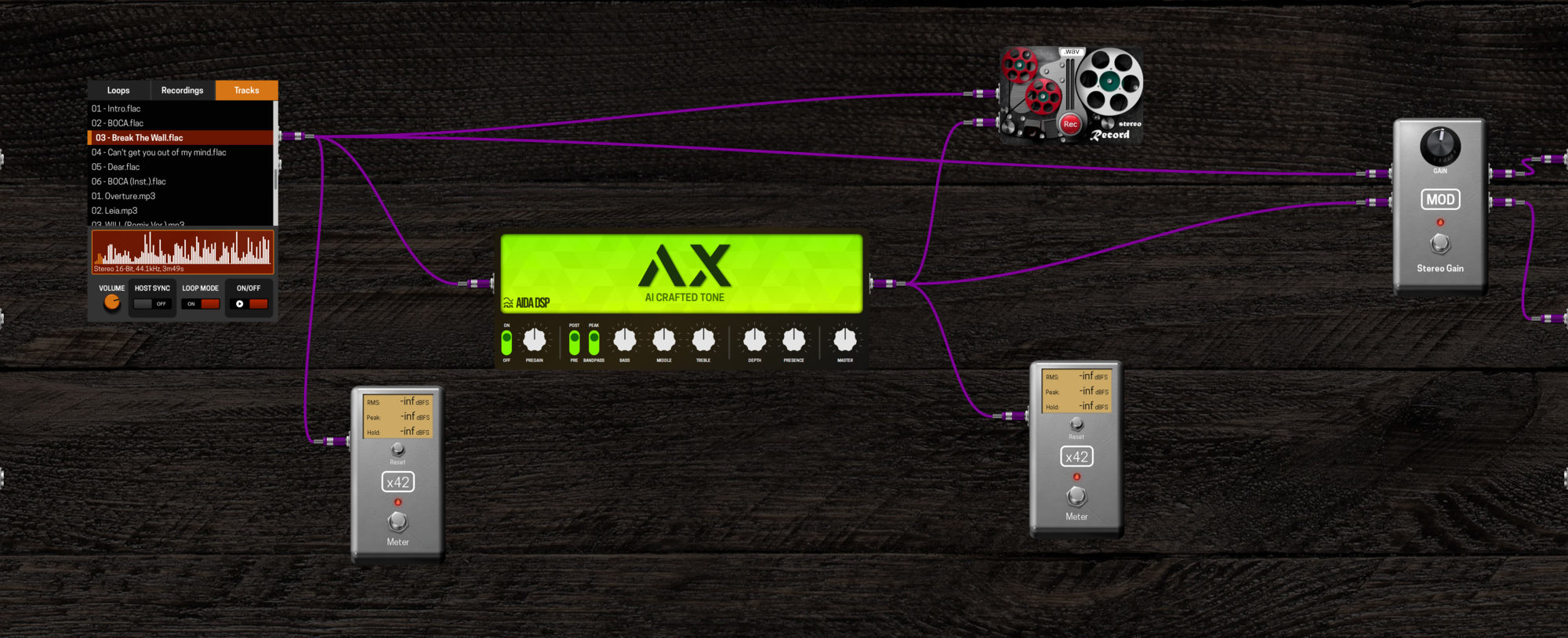

Many thanks, that’s a nice one, but very (too much?) CPU hungry on the Dwarf comparing to others, maybe too deeply learned…? Any possibility to implement a Normal/High fidelity parameter like the Vintage Cabinets plugin ?
Ok, I did a re-amp via the the AIDA-X and the Trainer with the original model (73% CPU on the Dwarf)
You’ll find two models here less CPU hungry and usable with cab and reverb, sounds pretty close… ;
MLTerror15_for_Dwarf_Standard 39%
MLTerror15_for_Dwarf_Heavy 48%
https://drive.google.com/drive/folders/1SI-QzCciF5F7GsvO7MfEqlHFvS9mlrkn?usp=share_link
Enjoy!
How is the re-amp done? You don’t have the input, output wav right?
Of course…it’s a kind of virtual re-amp.
  • play the “capture signal” input file through the AIDA-X (loaded with the model you want, EQ bypassed), record both outlets, separate your stereo file and you get your “input.wav” and “target.wav” files → training.
    a bit crude…but it works for me
It was about what I mentioned here
My idea was a unique pedal for transmitting and capturing audio, but using a stereo recorder was a good alternative.
@zwabo, did you had some trouble, or difficulty sync input and output audios?
Hey @jon, I think that this kind of pedalboard could be used as an example on wiki or aidadsp site as an example of capturing heavy plugins for training.
Not a problem to sync in Reaper, I did check the samples alignement after separating the L & R channels.
Here is the pedalboard
