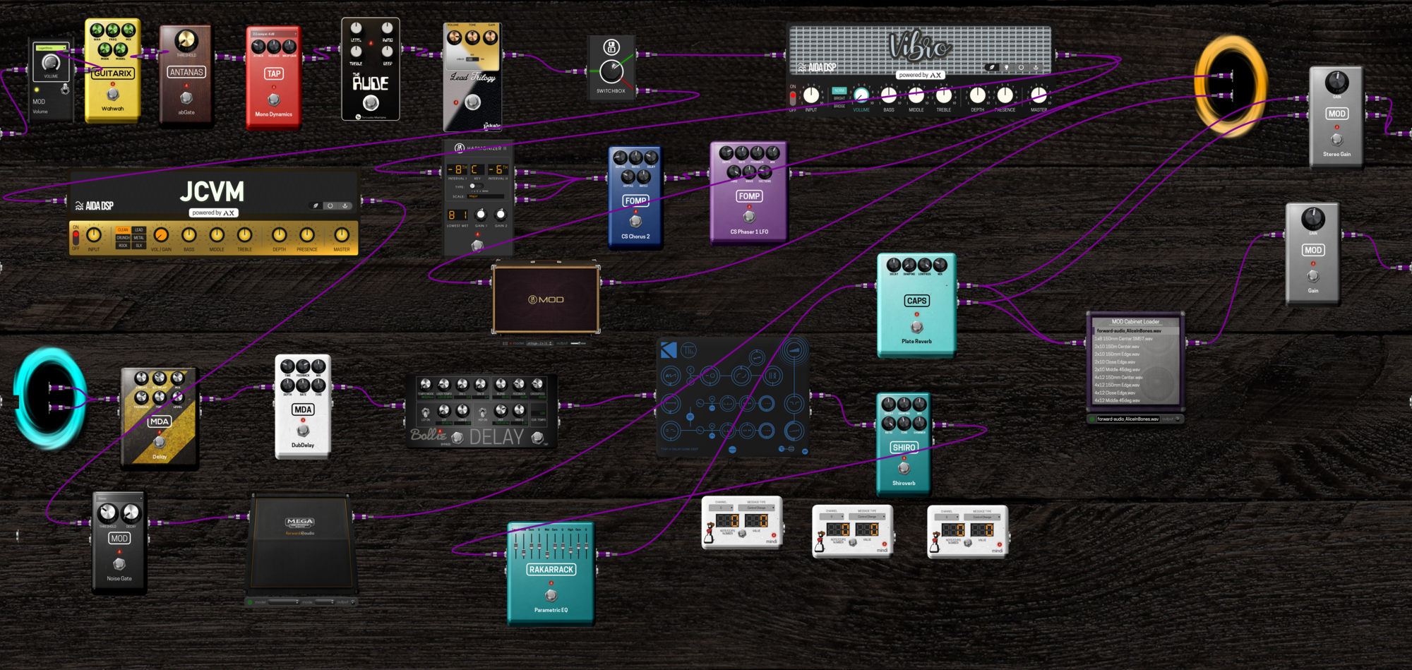

Ive tried several ways of using the Mindi plugin but still not able to use with an external midi pedal (fbv shortboard line6)- it appears that once i save the settings it starts bugging.
I have 3 Snapshot (1. Clean 2. OD 3. Solo)
I have set Mod settings to Channel 2 for Snapshot
Ive set the Mindi to Channel 1 and in Program Change mode
Mindi Was set ON
First attempt was to set assign footswitch on the External Pedal (Sending midi cc via USB) to control the Note/CC/PG number in the mindi and setting it to move from 0 to 1 in the advanced setting of the Mindi
Testing from Pedal Board worked.
But as soon as i connect the Mindi to the Virtual loopback- it works only once and then turn off automatically.
I’m not sure it’s the only problem you asked for a solution, but :
  • since Mindi is a plugin
  • and since a snapshot fixes the state of all the plugins
  • then if you aks withe Mindi to change a snapshot its state in this snapshot will be reinstored
    It may explain why it goes back to its 1st state ?
A workaround is to put the Mindi plugin after you’ve saved your 3 snapshots, so its state won’t be stored in the snapshot
Another one is to save your 3 snapshot with the right PC message
I hope I’ve understood your problem correctly
Yes Dude :slight_smile:
Many thanks :slight_smile:
It was each snapshot which was storing individual States but now its ok:)
Shared it here for future users :slight_smile:
If you got any advise to improve further - thanks beforehand :slight_smile:
