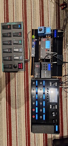

Everything wired correctly, no GUI on. Zoom, M5 and Helix all swapping nicely. Dwarf still nothing. Even swapped snapshot to channel 1 instead of program but still nothing…
The little black box is a homemade trs a and b to MIDI Din. So have checked both ways. The Dwarf is receiving midi via USB only although did try via TRS and still got nothing.
DO I need to select anything on the menu other than channel settings for program and snapshot?
It receives cc to alter pedals fine.
However on a lighter note Dwarf powers the Pacer and the Mvave nicely on only 1amp
