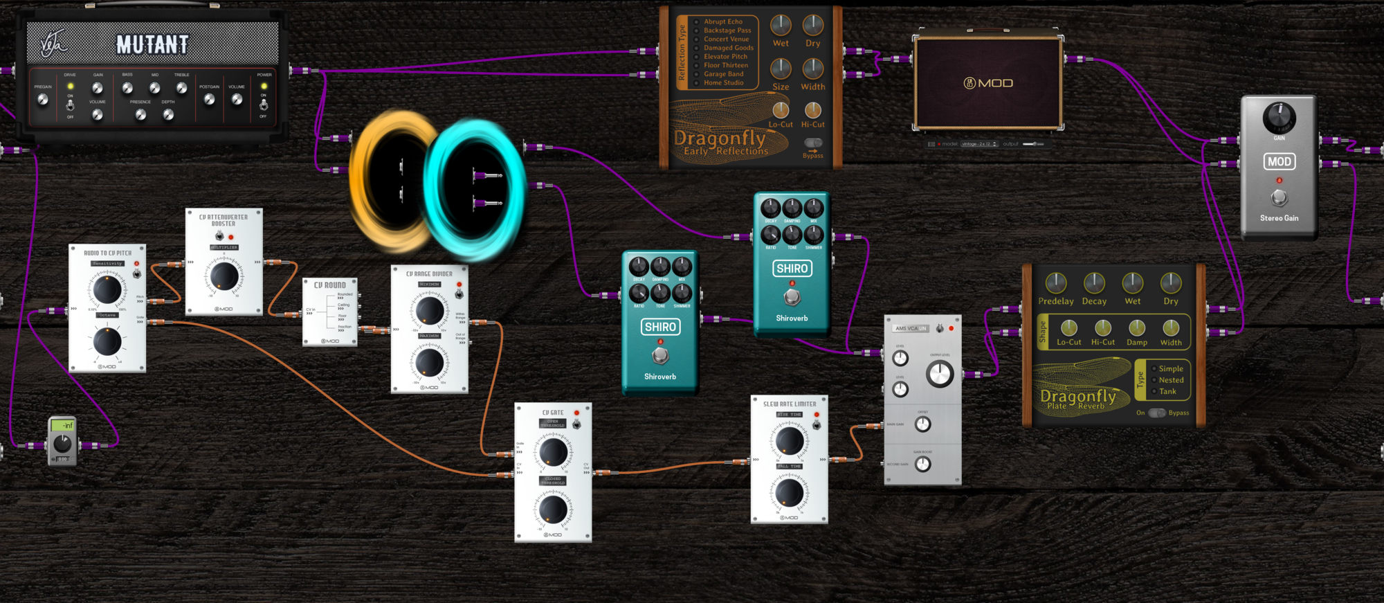

I was looking for a similar thing a while ago, but unlike you, I can’t code lol. This was my work around for the problem lol
The key splits work for me because I program my chord progressions in advance and can assign ranges based on the notes. I also record from a semi permanent location and can redo sections over until I’m happy with it, so my needs are a bit flexible.
The style of music I borrow from using long 8 bar chord progressions that don’t jump around much and rely on suspended chords to keep things “dreamy”. That also means I have a specified range for high and low notes
However, that set up probably wouldn’t be helpful/useful in a live situation or noodling.
Hopefully you can develop something that simplifies the workaround lol.
