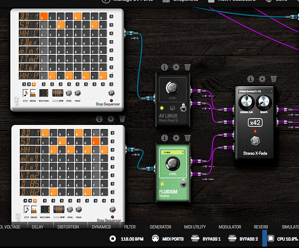

thanks for answering! Here I send you a photo of the patch … excuse my ignorance! How do I sync with main transport?
You need to press the sync button in between the BPM and PANIC.
The BPM should say Host Sync and then the sequencers will run together with the main transport controls.
Yes. both are in sync but it’s always the same. in the photo does not appear in sync but they are
They are not, they very clearly say 118 which means you set the BPM manually.
Press the sync button next to it to enable Host Sync.
