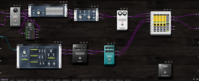

UPD: Today just loaded MDX as usual, with Opera browser (which I use exclusively only for MDX WEBGUI) and now these checkboxes come back. I Will test this during this day.
UPD2: I loaded my Pedalboard (on screenshot), and then switched to the default one, now this checkboxes disappeared again
UPD3: I did some tests, when im loading board from screenshot it crash this MIDI settings. If during session i switch to Default board, reboot MDX then it works again.
UPD4: This was the issue with Calf Synth, when i deleted it and saved the Board everything works fine. I know plugin in beta, but maybe this info will helps in future.

I always knew calf messing up with global css rules would be causing issues one day, this shows one of them.
Plugins should always be self-contained, never modifying or creating global state.
