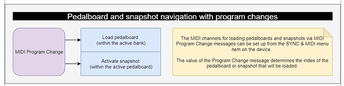

According to the information in the wiki:
As far as I see there’s no display of the required index in the WebGui that one should use for MIDI Program Change commands.
Currently this is just guessing numbers - or did I oversee something very obvious?
