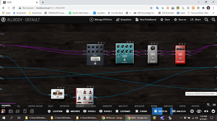

You’ll be a-ok. I have a Zoom MS-50G and just tested out a similar setup: I have a bunch of USB MIDI devices all connected to the Duo through a hub. There’s a lot going on in the below screenshot, but there’s one blue wire going from the USB MIDI out of my dirtywave M8 directly to the MIDI in on the Zoom. I was able to send program changes from the M8 to the Zoom no problem!
Cheers for testing that out fod me. Much appreciated and glad its working. Best get my self a hub and see what carnage I can cause.
