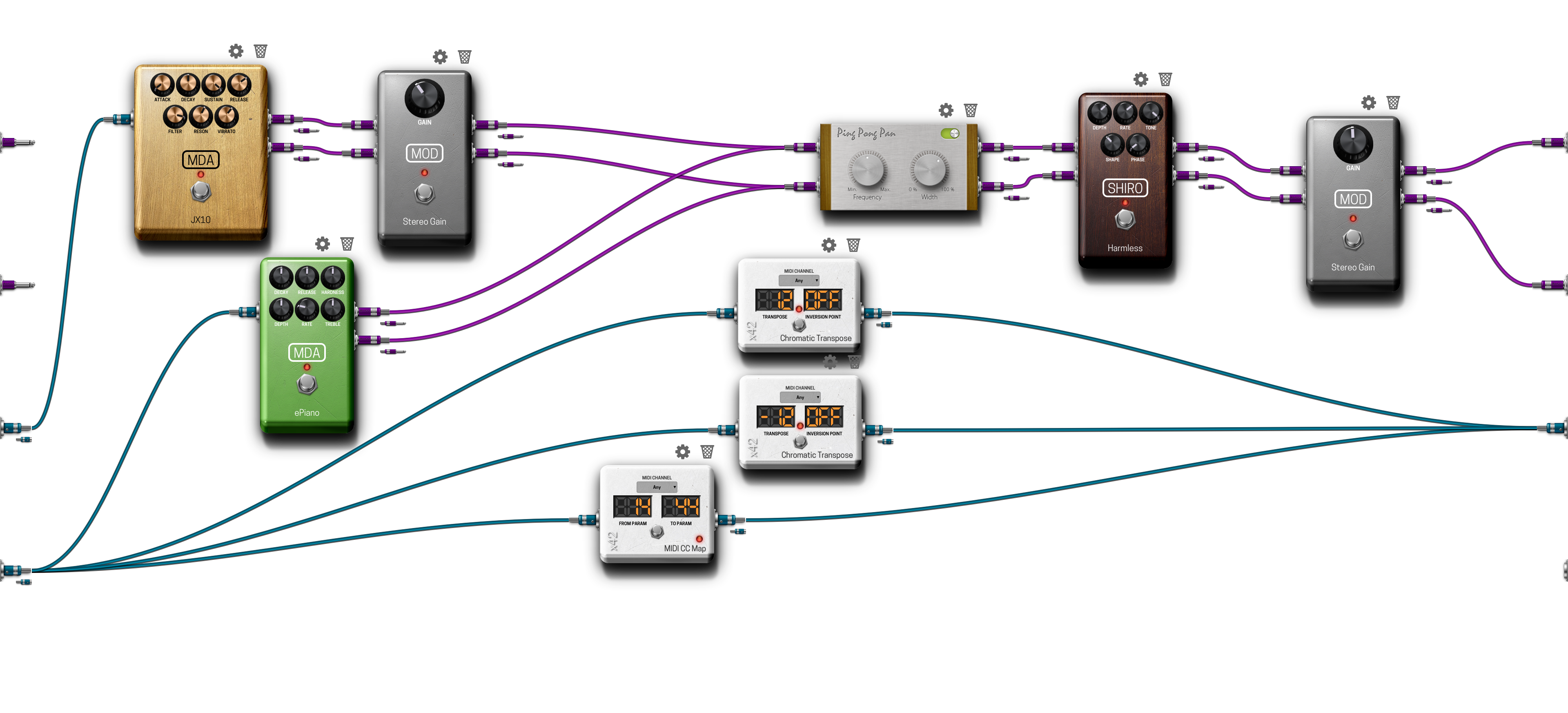

By connecting the DIN-MIDI output to the DIN-MIDI input, we can change the MIDI messages we are receiving, and use them for different plugins. In this board, we duplicate CC14 to CC44 to control two parameters at once (width of the pingpong panner and the depth of shiro harmless). We also transpose the note an octave down and an octave up. Try it out and get creative!
